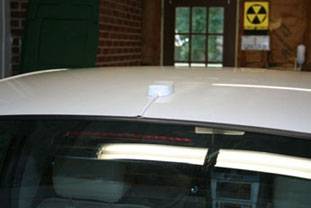

I stuck mine centered up on the 3rd brake light on the rear part of the roof. I ran the wire around and down the pass side under the back windshield weather seal and into the trunk. I laid the pass side back seat down and tucked the wire in the crack near the door. Then I ran the wire down the pass side of the car tucking it under the door threshold trim pieces. Once you get up to the front I ran it under the carpet up under the glovebox and worked it toward the center console.
As for the cigarette plug I used the outlet in the center console and the ran the wire under the dark gray trim all the way up to the stereo.
It sounds more complicated than it really is. It's a VERY clean install, no visible wires whatsoever. The mount from Kuda worked out very well also. Check out the link for pictures of the finsihed product.

I painted my antenna. My LS is Ceramic White (F6), so the black antenna stuck out really bad. However, after painting, it looks much better.
