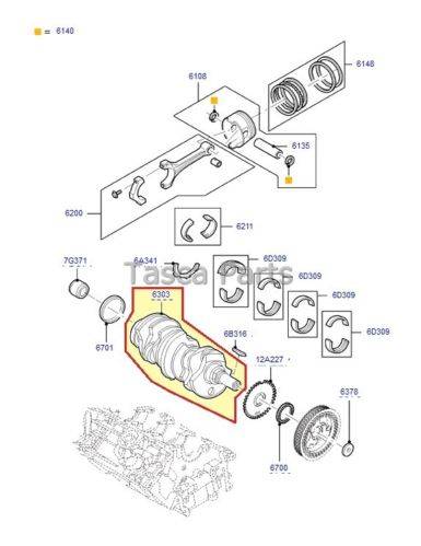

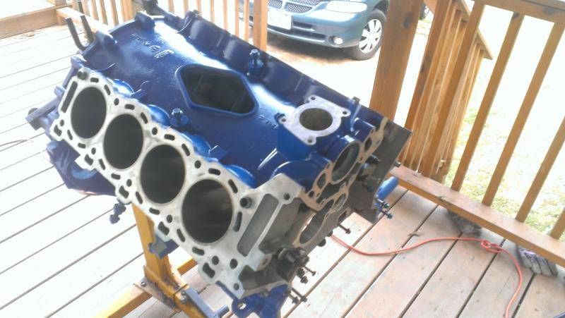

Do anyone know where I can get a complete set of rod bearings and main bearings for a 2002 lincoln ls v8 3.9 engine I've check everywhere even with Lincoln company but they want you to buy a short block engine because they have stop selling the bearings kits for the 3.9 engines but they sell em for the v6's:mad::mad::confused:, I have all the parts I need to rebuild my 3.9 except the bearings are any aftermarket kits out there or is there any other engine that uses the same main bearings and rod bearings.
