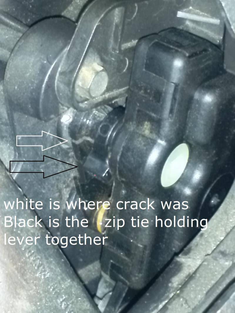

There is an easy quick fix, did mine two years ago and still works fine.
Remove the headlight switch (pull the dial for manual lights) and remove that small cover. Remove the dash part that has the vents in it (this goes over the dash with the tach and speedo). Remove the message center and behind it you will see the blend door actuator.

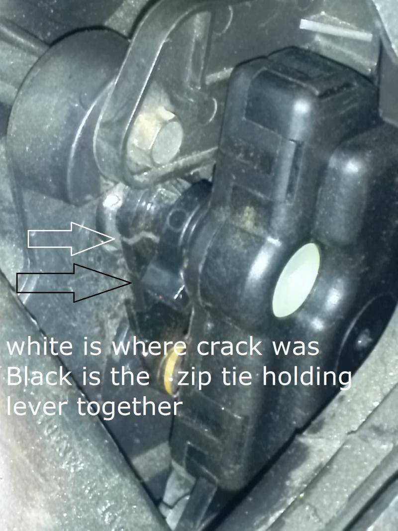

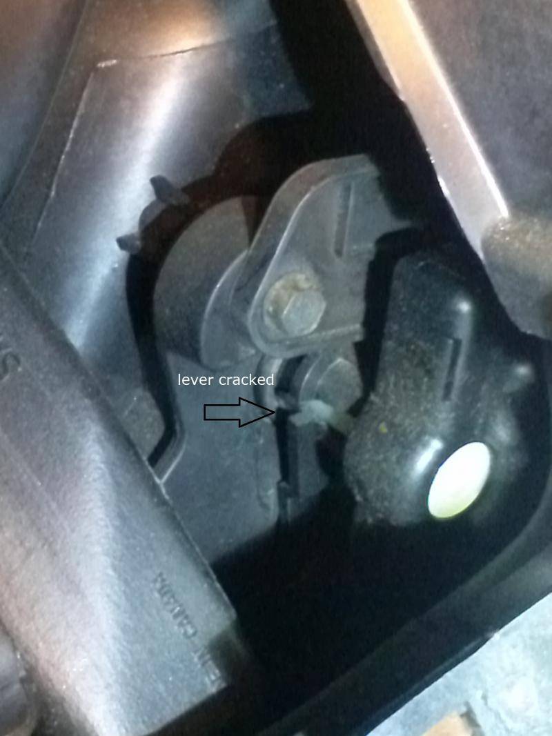

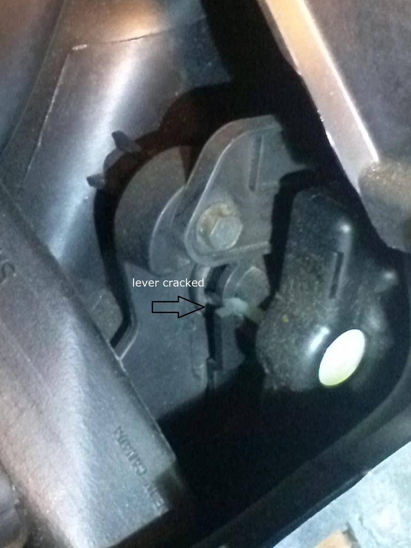

Cycle the car (when running) from cold to hot and see how the black plastic arm moves. I believe it moves to the pass. side for cold and to the driver for hot air. Yours will most likely be cracked. Gently help the arm with a screw driver it if doesn't go all the way (see my pics)
Once it is all the way, use a zip tie to go around the actuator arm and pull it tight. I would then use Auto goop (the best adhesive I've seen) to help reenforce the zip tie. Do not use too much! Or the arm won't spin back to cold. I have only use the zip tie for since 2013 and had to adjust it in 2014.

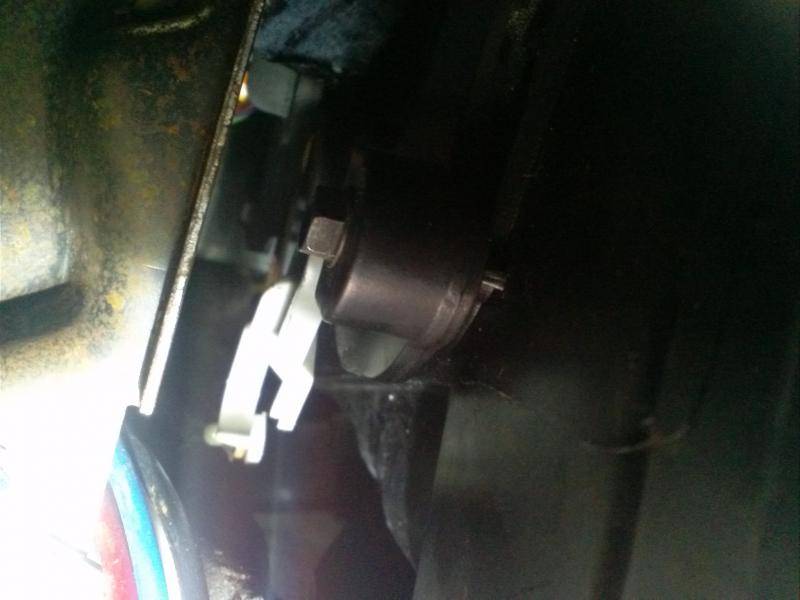

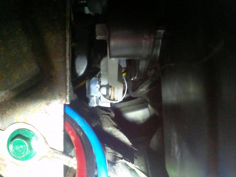

Also note: there is another grey arm under under the glove box. Both of the arms on my M8 were broken. I used a small hose clamp for the grey arm and it worked like a charm for a year and a half and fell off just recently (I didn't want to put it on too tight with concern that it make crack the arm). Only took 2 minutes to put it back on and it has been fine ever since.
See pics. Last one is the lower grey door.

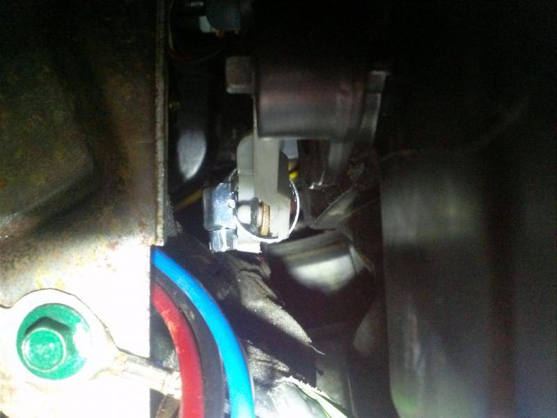

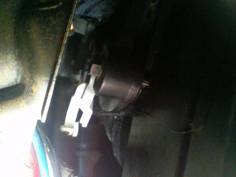

Broken grey arm:
Clamped grey arm:
