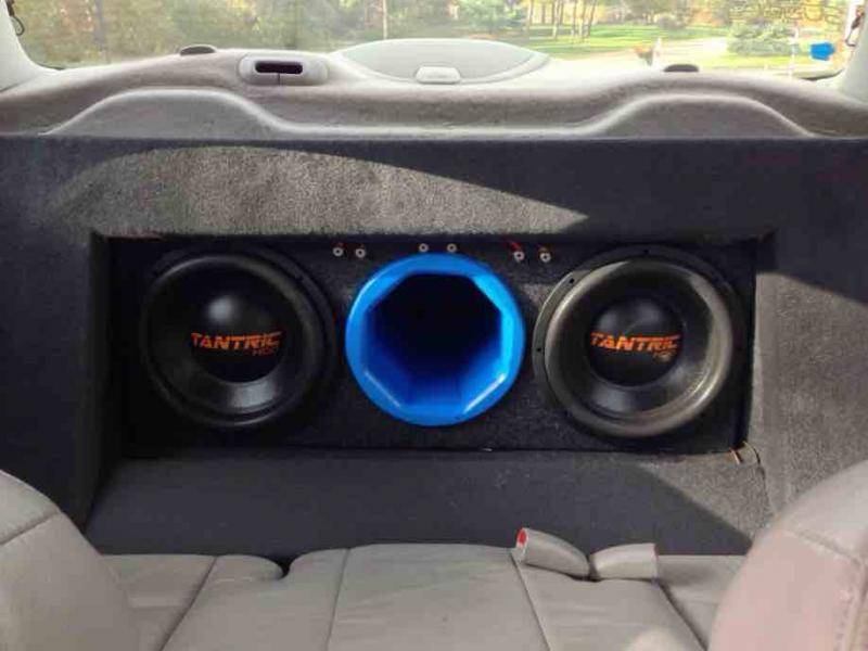

Hey guys, I am in need of removing my headliner to add sound deadener to my roof. I finally got my sound system in and my roof and sunroof flex like no tomorrow.
Any tips or hints are appreciated. Thanks everyone!

Lol yeah it's pretty intense, that's for sure. Right now it's about the same volume as a buddies system and he hit 142db on a termlab. I haven't completely set everything up yet, will be louder once it's all finished up :)

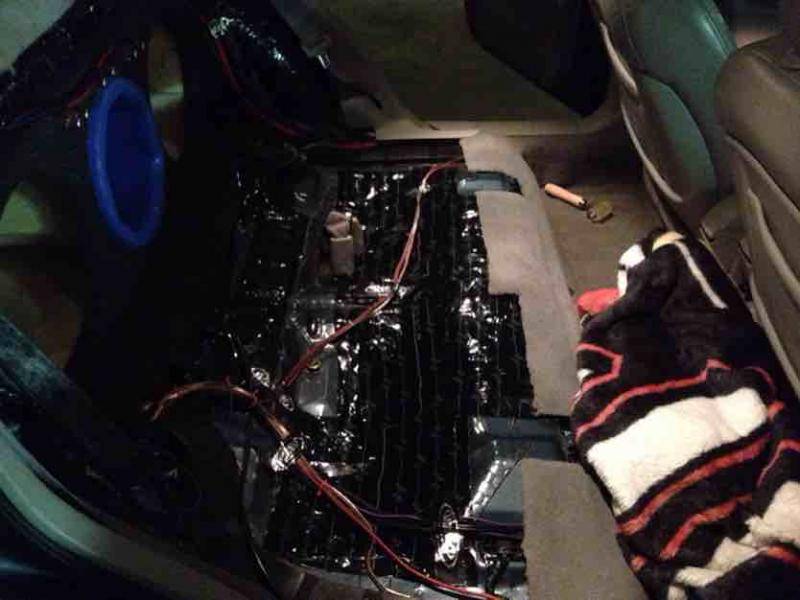

Sound deadener under the bottom back seat
I figured out how to remove it, simply have to pull down the A, B, and C pillar trim panels, remove front sun blockers/vanity mirrors, passenger and back seat "oh ****" handles and the whole thing will drop right down. Mine had two electrical plugs, one for the dome lights and universal garage door opener and another for the sunroof controls. I now have to take it back down again tomorrow, because the deadener didn't get warm enough to properly cure and started to droop down.

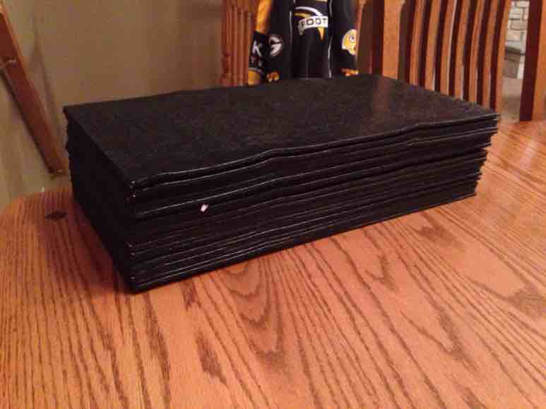

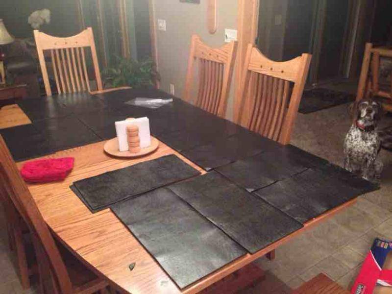

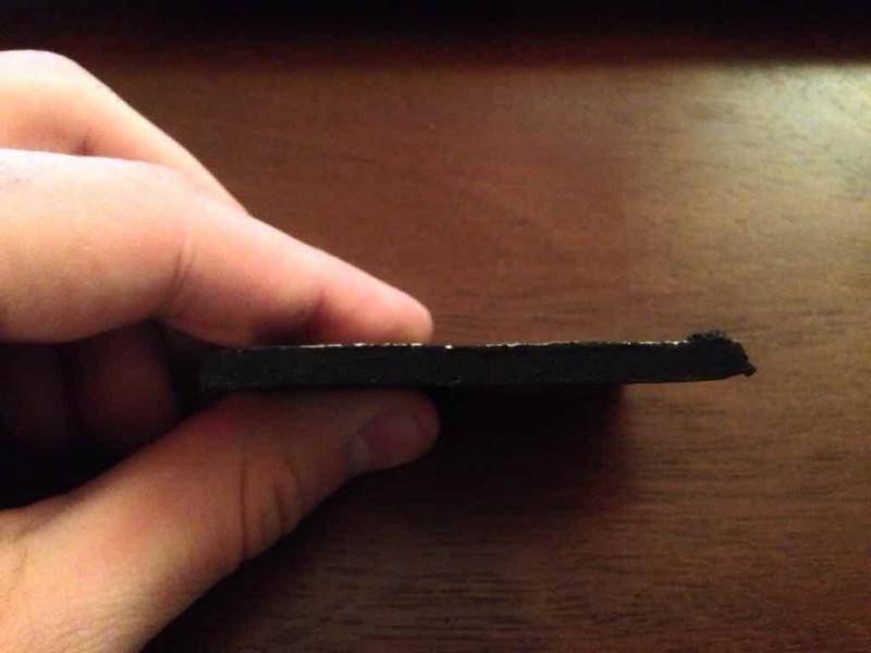

Pics of the deadener for reference:
This stuff is THICK.
Big ol stack
