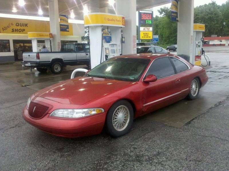

Picked up Darrens new Mark VIII... Driving home as I type, or the delightful Betsy Venn is hahahahaha...
Things are going smoothly, but the car has a few issues.
Door Handles are broken, air ride isn't working, abs light is on, and the message center buttons have a mind of their own... super weird.
And the seat tracks and taillight ballast are out :p.
Stoked for the car to get here, have a safe rest of the trip and thanks again for taking the time to do this for me. Next time I'm coming with :D
Well... unfortunately it's made it most of the way home but will have to make it the rest of the way like this:
That's right... on snowflakes :p. In all seriousness, the air ride issue is mildly concerning. The bags hold air okay but the compressor won't come on and there's a check air ride message... My understanding is the compressor and a relay have been swapped out with no improvement. Brandon thinks it might be the computer?
It gets and instant check air ride message as soon as you start the car, and yes, the relays and compressors have been swapped.
