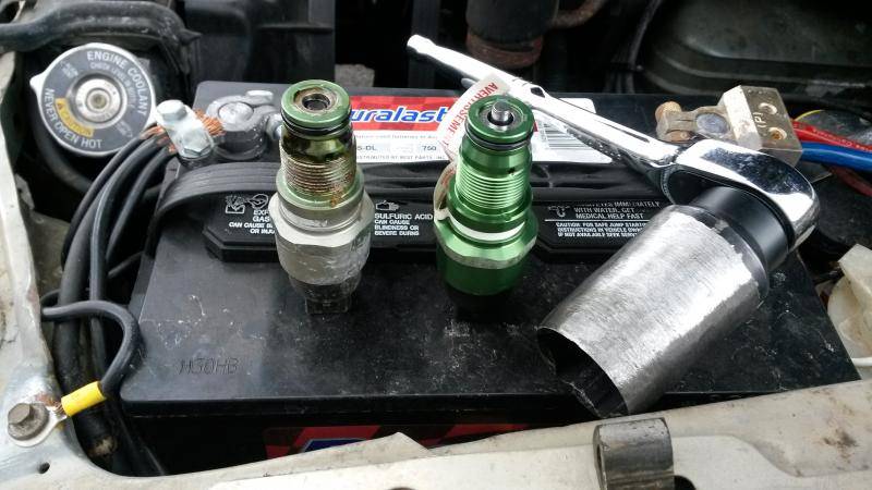

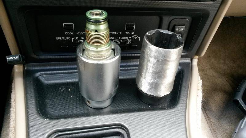

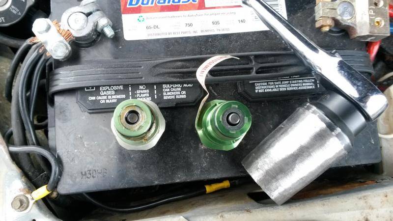

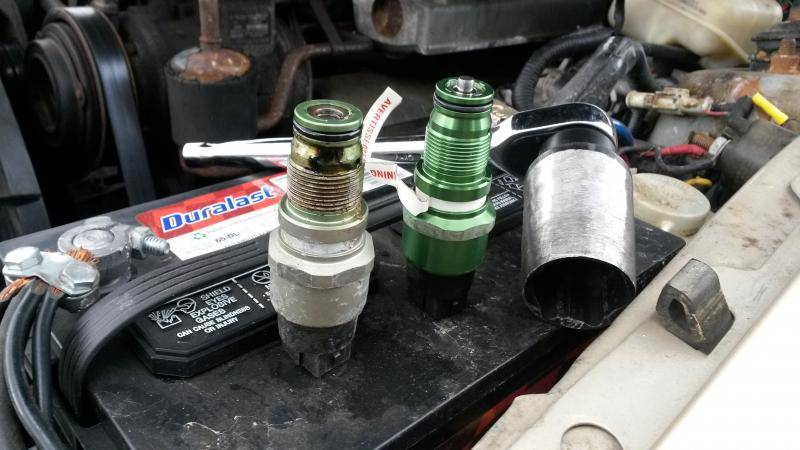

After many hrs of research and some diag.... It finally clicked once i noticed after changing the Accumulator Ball that I purchased from SpinningWheel.com and then the Relay. I noticed no fluid coming from the whole when I released the accumulator ball. I also jumped the 4 and 5 plug and the pump came on without any issues. It all came down to the brake pressure warning switch. I ordered one from a seller on ebay and WALLAH!!!!!! after more hrs of grinding down a 36mm deep socket first with my dremal and then going to my uncles shop and using his grinding machine. I finally removed the bad switch and in with the new!!!! Just have to bleed it properly.
