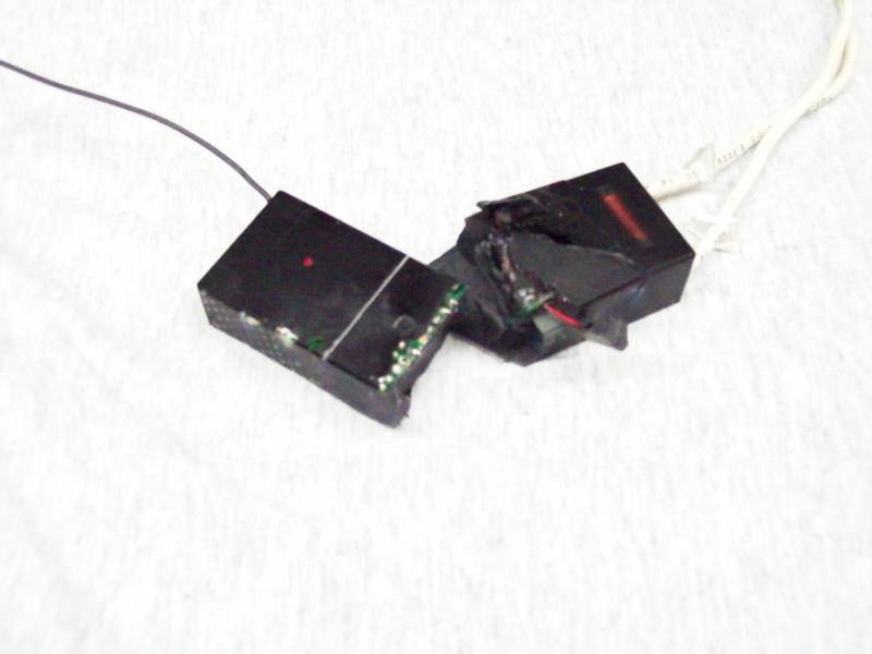

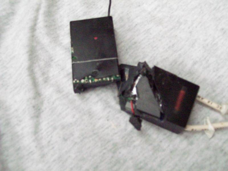

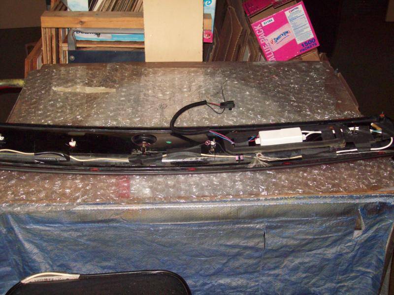

I just replaced a ballast, and I got one from neon ballast steve. The old one was also a Glitch, and I wondered what was inside of it. Of course it's encased in hard plastic. I figured 2 ballast in one package. There's a lot of electronic stuff in them. Now I know why they cost what they do, and it's a good deal, for what you get. Had to JB weld some attachment bolts back on, and now just to install it. Glitch open-2.jpg Glitch ready.jpg Glitch open.jpg

My problem with my neon was only parking lights would work. The guy I got the car from had changed the ballast, so I never checked it out. Bench tested ok, but installed same thing. Neon Steve told me that sometimes you have to switch the 2 wires. I did and works as it should. 2 glitch ballast, 1 older, 1 new, both with different color wires, and didn't match what the car has. In the car one wire is larger, it's for the brake light. It works as it should
