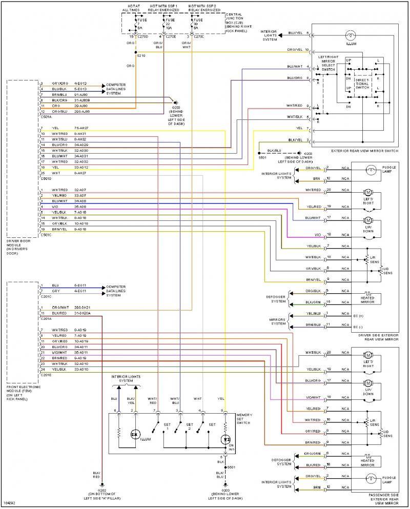

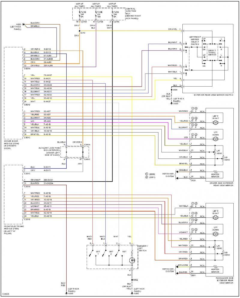

For those of you that have a Gen 1 and put on the folding mirrors what is involved wiring wise??? Is the connector the same??? Will the puddle lights work or need to run a separate wire??? If connector is the same are the wire locations in the connector the same?? Anyone have wiring diagrams for the both???

Gen I
Gen II
IIRC the harness is the same but the gen2 mirror side has more wires (puddle lamp and heat IIRC). I didnt use the heated mirrors. I tied into the light on the inner door pannel and wired in my own connector and power to the pudddle lamps.
I did the same as Hite. Just wired the puddle light to the door.
