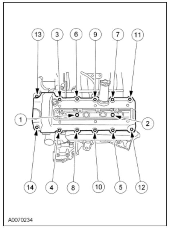

Looking for torque specs/sequence for gen2 v8. Specificaly driver side.. Very limited space on the bottom of the cover. Fuel line has to be disconnected to remove it? Seems all of the older links here are dead.
Yep, you have to disconnect the fuel line and move a few things aside. And yep pretty cozy on that side..
Image is LH bolt sequence
Torque spec is 89 lb-in (10Nm) for the valve covers
