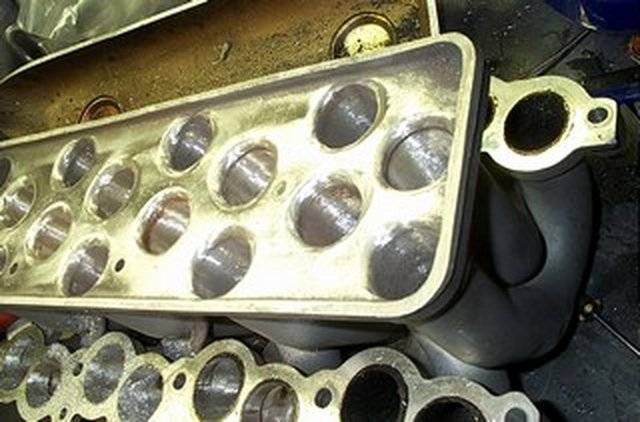

You can't really port the Gen1 intakes, the tubes are too thin. You can radius the inlets of the tubes however once you saw the plenum apart.
The proper radius is 1/8". You can do it by hand with dressing wheels and a die grinder or make quick work of it with a carbide router bit. Trust me on this, the proper radius is crucial to maximum flow.
Then polish it up all nice and smooth as far as you can reach in the tubes as well as the plenum before you TIG weld it back together. Be sure to throughly clean and polish the IMRCs as well as gasket matching as much as possible but it really doesn't need that much work.

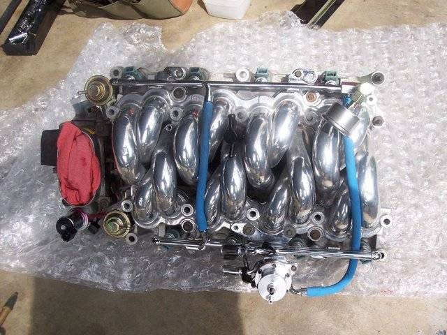

Besides, you can take the money you save from the Cobra intake and have the Gen1 intake coated and polished for that bling appeal you was looking for. ;)
that looks sweet driller. im not good with all of the intake work or port/radius work. how much do you charge????????????lol

You would wnat to cut it apart and rough it in, weld it back together and then get it honed... the results would be good I'm sure... I think that intake is one of the BEST looking that there is...
driller who can i get to radius those tubes.
No way I have time for anything like that now. I had an intake getting worked on once and my intake and money disappeared.
It's really a DIY project. You can take it to a machine shop or welding shop to have it cut apart. Then you could do the time consuming work and then take it back and have them TIG weld it back together. It's not rocket science.
