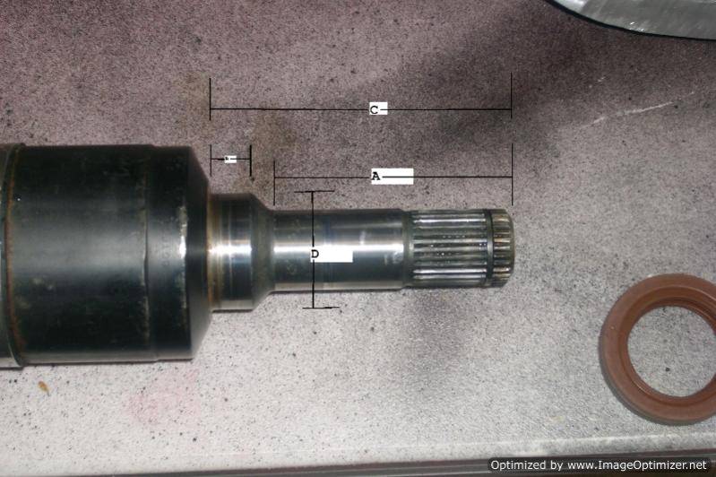

Could someone with a GEN 1 axle laying around get a couple measurements for me. Trying to install an 8.8 rear end in a GEN 2 car. The original thread on this build states you need GEN 1 axles but I want to make sure because parts store is telling me they are a special order non-return item.
I need measurements:
A
B
C
D
inches or mm is fine. Sorry about the crude picture, I don't have any photo shop program.
Thanks alot.
Pete

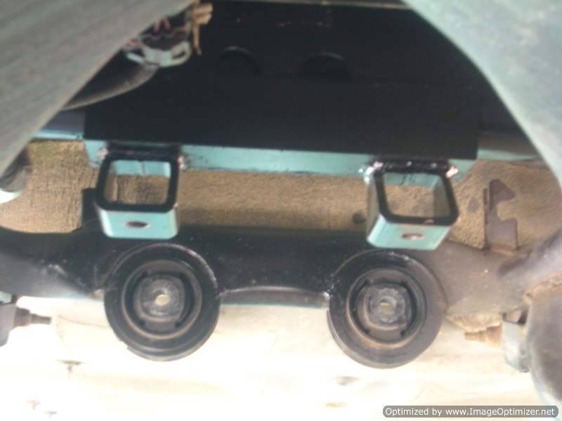

Would you be willing to fab up another mounting bracket when you get around to that step?
I would but, I went a different road and took the entire sub-frame out and took it to work and made the mounts with the housing mounted to it on the bench.
Some more pics of your swap would be awesome as I wanna do the swap in about a months time, I will also see if I can get measurements from work
A
B
C
D
Thanks alot.
Pete
Sorry it took so long. When your busy at work you forget a lot of things.
A.) 3.45 inches
B.) 1.5 inches
C.) 5.38 inches
D.) 1.575 inches
Hope this helped. :D
