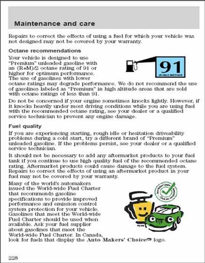

I just purchased a 2002 LS V8 and I don't have the manual with me. Does it need or prefer premium gas? If so what octance gives the best performance?
Thanks
Thanks
It states in the owners manual that the LS was designed to use Premium fuel. Here's a snap shot of page 228 in my owners manual:
It should also give you the octane requirement on the inside of the gas cap cover.
