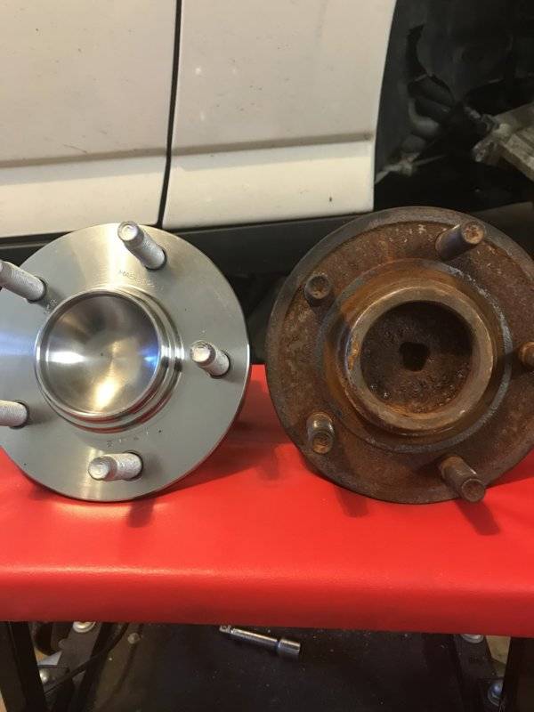

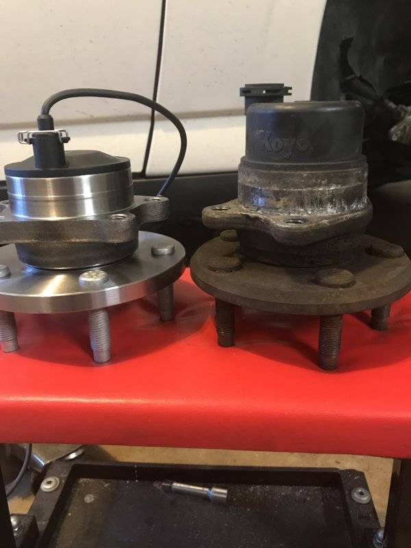

Timkens came in today. I’m a little leery of the fitment although most dimensions look the same. Clearly the Timken is shorter from bolts to sensor housing, especially the sensor area. The measurements are within a few thousands of an inch or the same as other manufacturers.
The inner flange where the inner wheel diameter touches is thinner especially at the top. And although wheel pilot is not tapered, making it look thicker, it’s actually thinner than the OEM
I have an email out to Timken to make sure this hub does fit. Overall quality and machining looks good and smooth, but the pictures show there is no squared notch in middle of hub and the face doesn’t have the groove in the middle like the OEM.

The missing "notch" in the new hub is probably not that important, but the flat face of the hub is probably going to make future wheel removal a nightmare. They did it to save a machining and tooling step... thus saving money.
The back of the new hub assembly concerns me more with its condensed
size. Less space means smaller parts,,, which to me means faster wear.

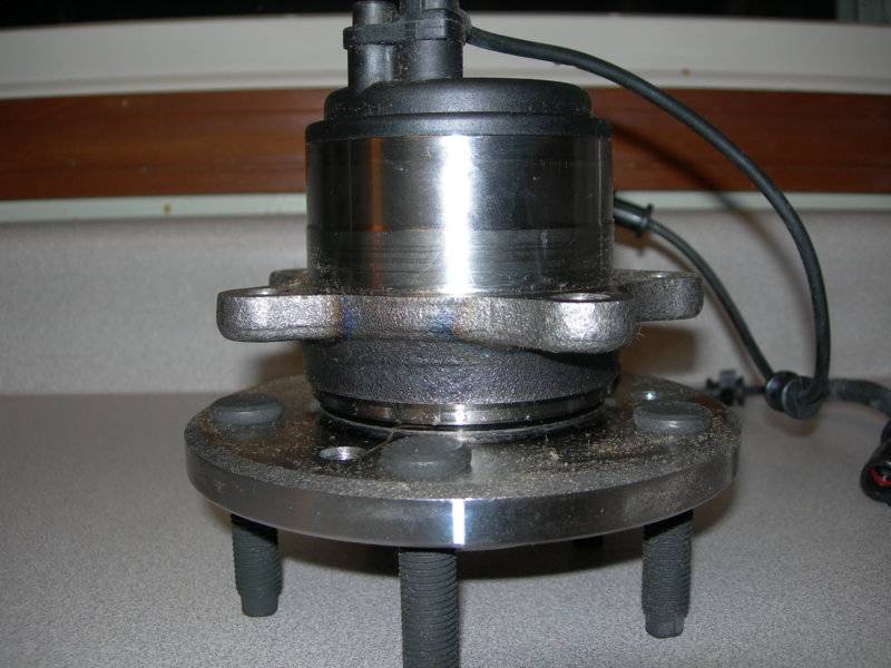

The shorter depth of the black plastic cap could just be a generational thing (newer design). I say this because when I replaced my bearing with the Timken HA590213, the depth, style of the casting, and overall appearance was virtually indistinguishable to the original bearing that was in my car.
I agree that it's a different design,,, however if you look at them both you'll notice that the hole for the ABS sensor is also located closer to the bearing(s) on the new hub. The older, (OEM) style has a deeper cap because the tone ring for the ABS is housed in that cap.
To me... that says that the bearings in the new hub are smaller,,, to make room for the tone ring. Probably changed from roller bearings to ball bearings. I might be wrong, but I thing the newer design might have a shorter lifespan,,, plus with the other, (cheaper), manufacturing shortcuts the new Timkens are something I would personally not buy unless stranded and desparate.
