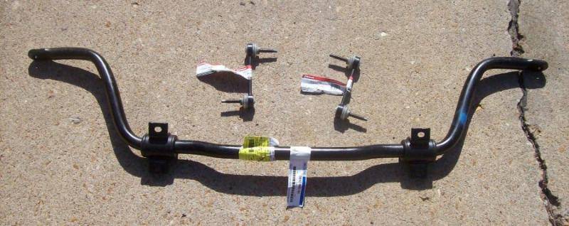

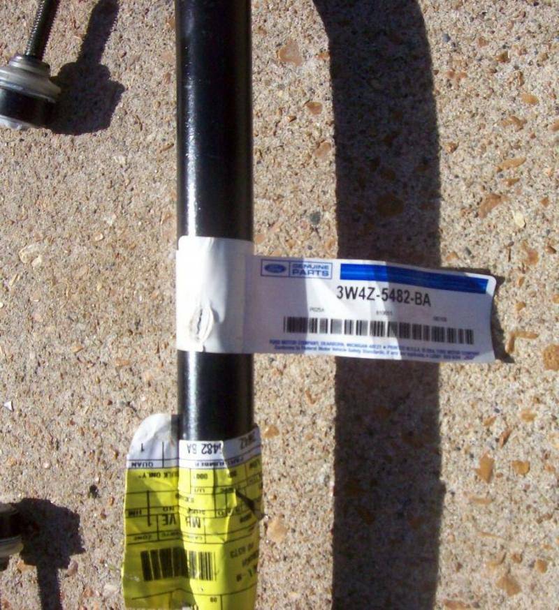

Early Lincoln LS's had problems with front suspension noise and wear at the front Stabilizer bushings. Ford came out with an improved front stabilizer bar with compressed rubber bushings that will last the life of the car. It also slightly changes the front spring rate and body roll rate resulting in improved handling. This bar is a must for any 2000-2001 LS. There originally was a bar for Sport Pkg. and non Sport pkg. The bar shown is for Sport Package. If you have a 2002 look for this bar type, it's probably already on the car. If you have a 2003-2006 it is already factory installed. The end links shown in picture Ford links which are much cheaper than the Moog. links. The Moog links. Don't try this upgrade yourself! Leave this to a pro. The front cross-member has to be lowered and one control arm has to be removed. If not familiar with this repair procedure damage to the front fluid filled control arm bushings (with plastic spacers) or the A/C & P/S lines. The alignment settings will be lost, so an alignment is needed immediately after repairs. I have done dozens of these upgrades and it's not a bad job if done properly. Parts are reasonable and labor is reasonable. Make sure the alignment is right or this car will not drive properly. Have alignment settings for handling & driveabililty.

I'd probably recommend the Moog end links. They do seem to last longer and are serviceable. At least as far as shooting fresh grease in them.
When I needed the rears the Ford ones weren't any cheaper.

I would also reccomend the moog links or atleast the deeza links with the grease fitting. I dont like the design of the oem links. The rod is thinner and they are not greaseable.
The Moog links are heavier adding to unsprung weight. Also check ball preload if higher or more friction car will not respond to bumps properly. I still recommend the factory ones. Remember I raced on a factory suspension with the bar upgrade. It works very well.
