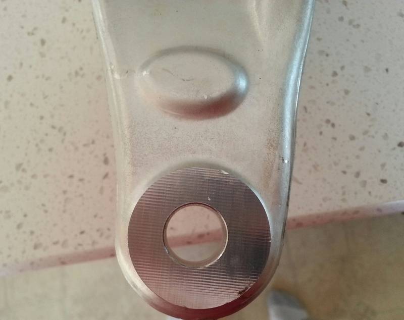

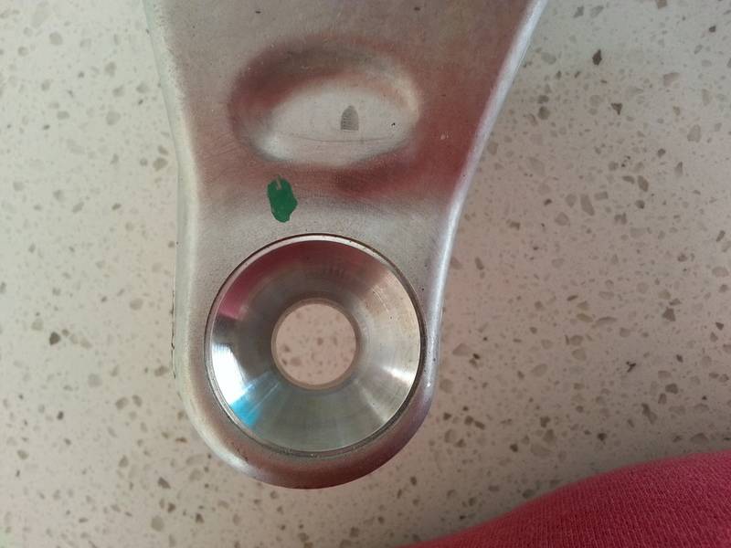

I bought replacement outer tie rods (moog) anyway to eliminate that factor. I also decided to (try to) buy Moog RK80734/5 control arms (rockauto) since I don't want my daily driver apart in my driveway if bushings don't fit. However, I am less than impressed with the control arm I got (I have yet to get shipping info for the passenger side arm 1 week after placing my order and it was available at the time of order). My major issue with the arm is that the machining for the ball joint was off center, and the large chamfer extends into the radius on the edge of the part. Its hard to tell if the casting is bad, or simply the machining. Either method is not very confidence inspiring. After a few go-rounds with rockauto, they contacted Moog who agreed the part is bad (even though some schmuck put a green paint dot on it to presumable pass inspection). If they can get me a replacement, and the passenger side arm in a timely manner, I may still use these. Obviously I'll be scrutinizing them closely. They may just end up as back up parts if the poly bushings option fails for some unforeseen reason. Here are some shots of the control arm...

I just received my AC Delco "Pro" grade passengers side LCA and the balljoint appears to be slightly off-center from the casting but I am not sure if that's an issue. The reason why you do finish machining is because a casting is not accurate enough. I wouldn't worry about the balljoint being slightly off center. I would be more worried about the ball joint fitting into the arm properly.
