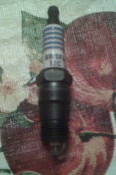

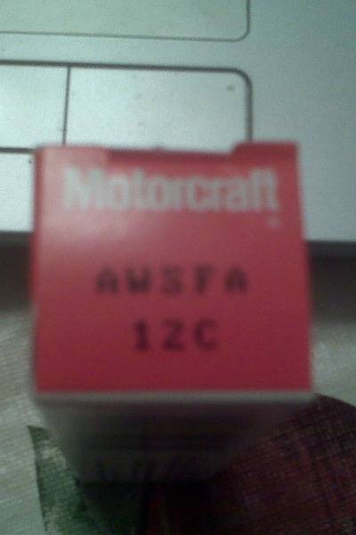

again awsf-12C's your running are relatively the same as AGSF-12FM1 or whatever the stock '01 and up Lighnting plugs are.
Like I said, be prepared at the dealer if you want those plugs, they are like 9 bucks a piece.
i "got not made anymore" right from the people who make the product, Motorcraft.
My point is that there is no guessing with the Autolites, they are great for the price and you can get the same heat ranges as the magical motorcrafts at a fraction of the cost. You can also buy them from your local parts guy over the counter.
Driller, do me a favor - Stop by a ford dealer near you and eyeball the AGSF-12FM1 '01 lightning plug finewire, im sure they look exactly the same as the awsfa 12c plug. Better yet, have your FLM parts guy call Motorcraft direct and try to order those plugs since you don't believe me? :shifty: :p :rolleyes: :rolleyes: ;) :mad: :( :) :p :D :rolleyes:
No finewire here...
they dont. i have many FM plugs in my garage and would have no problem taking a pic of 1 if you like.
