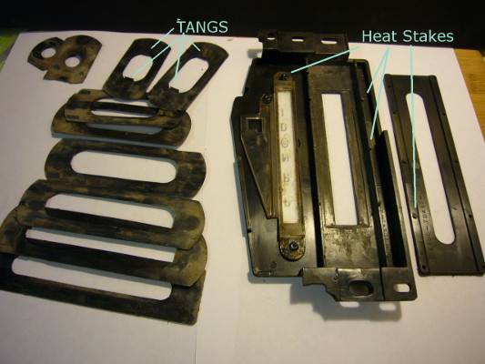

While doing that, fixed the gear shifter "accordion" cover plate thingies.. They were filthy and not operating correctly. Took photos of that internal assembly.... if anyone is curious about how it works and what went wrong.
The moving plates are just a stack of thin vinyl plastic pieces with 90-degree tangs bent up on both ends of the holes. Many were broken off. New plates can be cut with scissors or the old might be repaired.
The assembly is "heat staked" together. Many stakes were broken.... A soldering iron can easily tack-weld things back together.
A higher resolution photo is here: http://i.imgur.com/3wmsBee.jpg
