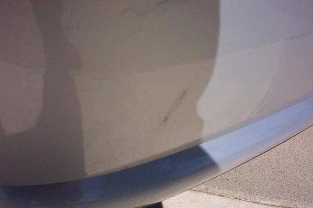

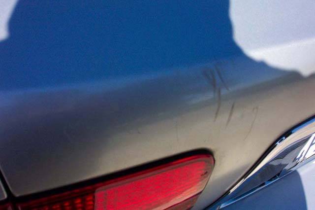

yesterday i was backing up into a driveway but this street didn't have any sidwealks so there was a bush right at the forner of the driveway and its just under my rear view mirror visibility and so i hit it and it left some ugly scratches on my trunk. should i wetsand, buff, repaint???? I want to take care of this in the cheapest way possible. I will take a picture of it.
here are the pics, if you want bigger ones let me know. They don't seem to be too deep. But i have no idea what to do and i don't want to screw it up even more.
If you can feel them with your fingernail they won't come out very easy. If you can't feel them Meguiars make stuff called Scratch-X that will make them go away just follow the directions on the tube.

for the deep scratches I use touch up paint, color matched, and a product called langka. For ht e light scratches I use scratchX.

ok so no one recommends using 1500 grit sandpaper and wetsanding it then recoating it with clear???
