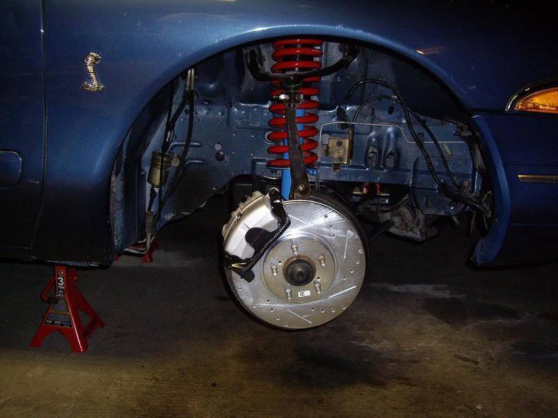

few day time pics of new brakes.
Lincoln Mark VIII
  1. BAD97LSC
    BAD97LSC Dedicated LVC Member
    Messages:
    9,541
    Likes Received:
    10
    Joined:
    Nov 15, 2006
    Location:
    Palm Harbor FL

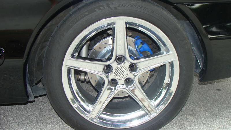

    i did my brakes last week before we left for the keys but didnt take any day pics, the new rotors look great on the car and the calipers are now blue. the car stops so much better now and i have zero vibration when braking unlike i did with the old cobra rotors. i also clay bar'd the car i havent done anything since having it pro buffed and it was looking sad, it looks like it did the day i had it buffed again.

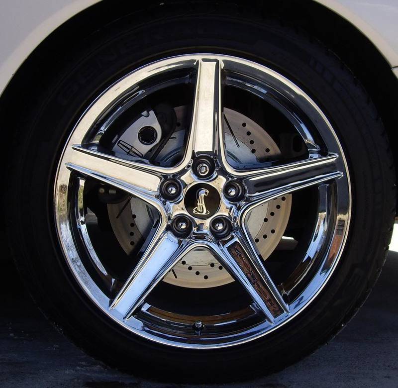

    Jamie, your rotors are on backwards. :lol:

    Also, please be on top of them. My rotors ended up cracking in 14 spots around the vent holes. :( They just sent me another set and changed them to just slotted since my rears already were replaced by them under warrenty. The holes look cool but if you drive spirited like me then they can get hurt kinda easy. The slotted versions will be more durable.

    the rotors arent on backwards the slots are supposed to go forward thats how they trap air, if they were the other way the slots would be facing the wrong way. you have yours on backwards.

    Did ya not notice the little "L" and "R" stickers on them? I understand your though but they are still on backwards.

    far be it from me to insinuate that an expert is wrong...
    SO... Bill, YOUR wrong.
    PS the slots are not for "catching air" they are for giving hot gases a place to escape so the pads can remain in contact with the rotor.

    Honestly, I'm sure that on our cars, hell even all the way up to F1 :q:q:q:q, the direction of the rotors really doesn't matter. I have seen though where the vanes inside the rotor can make a difference.

    ...and I personally don't care if you leave them on the wrong way or not..but since I AM a brake/susspension/steering EXPERT ....they are on backwards and if you continue to run them that way..they will wear out faster and blah blah blah...your car thou dude, do what ya want

    Check the vanes inside as Dan mentioned. Some manufactures have them facing the 'wrong' way though the inside vanes do face the right way...

    It was a question I had the first time I ever bought these kind of rotors before. I believe they should only face that way (how Jamie has them) if there are no slots and the rotors are ceramic. The slots clean the pads and you want that to push the crap to the outside to be discarded, not the inside. Also the cooling principal is different. The rotors get hit on the face with air and it goes in the holes and pushes the air out of the veins.
