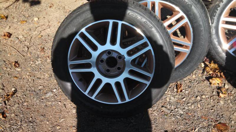

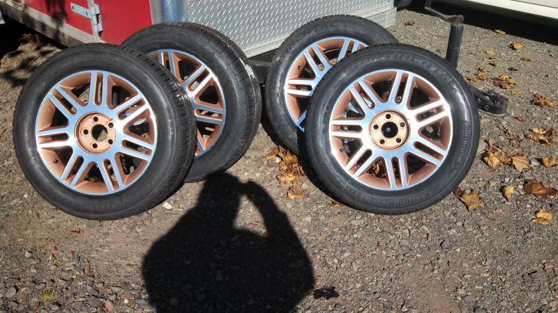

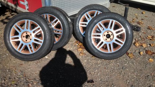

One thing left for next week because I want to enjoy my car a bit is to get the alignment checked with the new tires. Hmmmm might keep this car a bit longer now. IMG_20131028_175444_275.jpgIMG_20131026_113035_708.jpgIMG_20131026_113105_769.jpg
Here are a few pics of the wheels and car. Sorry it does need a bath especially with the new wheels.
Interesting. Those wheels should look nice against that white pearl paint.
Thanks...in fact they do. I have a parchment interior and decided on something a little darker and of course it had to have some pizzaz. Almond mocha sparkle was my choice.
