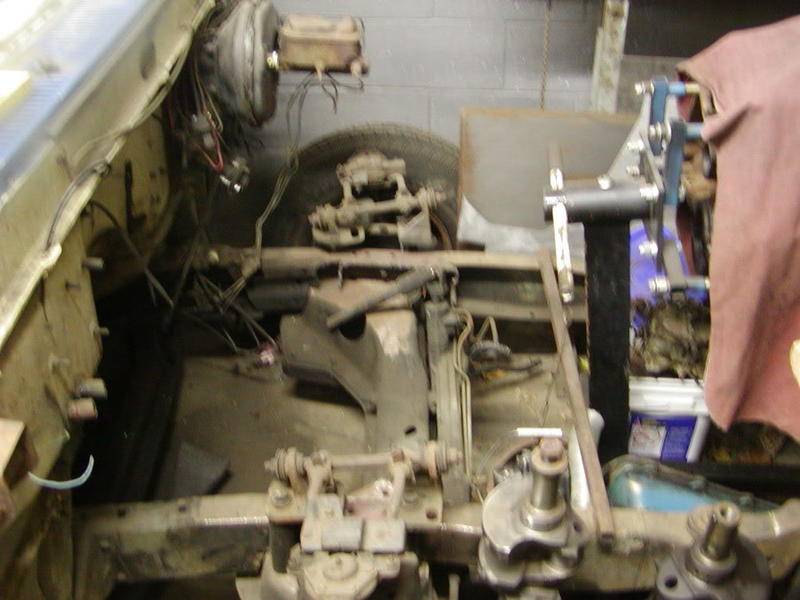

First thing was tear it apart..

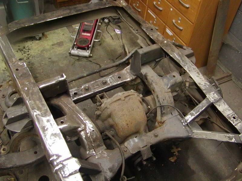

Put a MN12 IRS out back.
Tacked in an Aerostar IFS, which I hate.

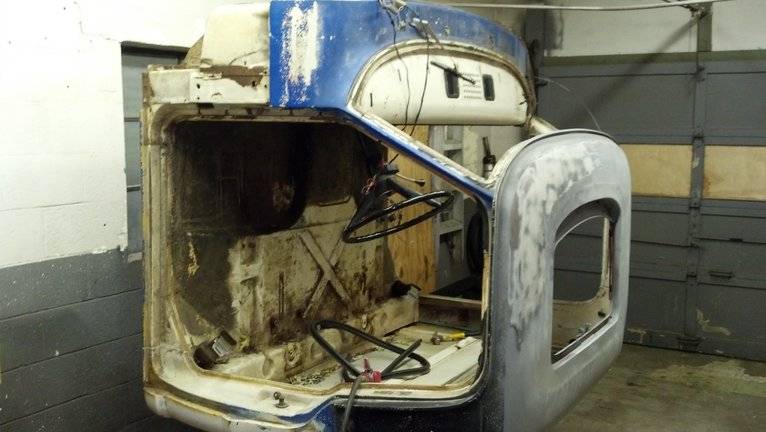

The boys and I worked on it this fall and unbolted the cab from the frame and brought it into the garage to work on.
Need to replace the floor pans and front mounts and figure out the roof.
I had repaired the floors prior, but now I want proper pans.
I'm picking up another roof for it so I spent sometime prepping the cab by removing the entire roof. Now I need to drill out all the spotwelds along the back of the cab where the roof met the rear cab wall. I can't redo the spots as the interior sheetmetal is in place. So I'm just going to lap the skin at the front of the cab and weld along the seam that was originally spotwelded.

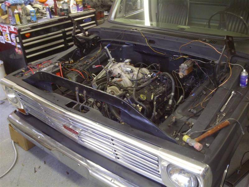

There is a guy in Chicago I sold the engine to. I forget which year his truck was, but it looks similar to yours, maybe a bit newer.
He's using the crown vic IFS as well (had it installed before for a 5.0), and the engine dropped right in.
