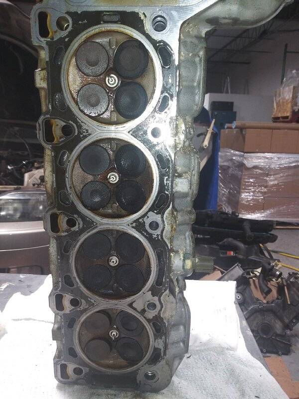

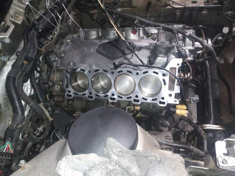

Hi guys, I have a 2001 Lincoln LS V8. 150,000 miles. I had a secondary timing chain break which bent the 2 exhaust valve on the number 7 cylinder. So I pulled it apart and replaced all valves on both heads with new valves and smoothed out the intake and exhaust runners with sandpaper wheels. No porting at all. New valve steam seals. Twice now just to be safe because of the issue I'm getting to. Reseated the valves. New head gaskets. Front cover gasket. Intake manifold gasket. Everything. I did cut the cats off for easier access to exhaust manifolds. Compression checked the number 7 cylinder today and got back 130psi.
So the issue is I'm getting oil in the intake manifold. I'd say around half a normal coffee cup. Maybe less. I've tried disconnecting the pvc hose the goes from passenger side valve cover to the intake manifold to see if that stopped the oil but it has not. The car is running rough and seems to be lacking power. It did sit for almost 2 years before I was able to get back to looking at it. This is after I originally fixed it. I wanted to see if anyone can help me out and point me to something I'm over looking or something I just haven't considered. I'll post picks from before and after I fixed the valves. Thanks for taking the time to read through all this.

So I did do the oil fill cap test and have no air pushing out at all. The oil is going through the exhaust and coming out of the muffler only on the passenger side. So that makes me wonder if maybe something else is going on and causing it to pick the oil up instead of it just sitting there. I'll get a picture of the amount of oil that sitting in the intake once I run the car for a little bit. It doesn't take long for it to build back up. Another quick question. If it were the piston rings wouldn't I also have gas in the oil?
2000sportv8
Nov 20, 2019
21
Lancaster, oh
Shouldn't your compression test results be in the 200+ range? Sounds like a piston ring defect, like what tends to happen on Subaru cylinder 4. I had a brand new block crack a ring land at 18K miles, you almost needed a macroscope to see the fault with the piston removed. Its compression was down from 140 psi to 60 psi with almost no visible damage. Do all pistons make it to top dead center? No bent rods? Well at least your heads may be ok, but maybe not, there could also be hidden damage from the valves it bent. Good luck with the repair.
Yes they all come all the way up to top.of block. That's how I was able to clean them with out damaging the cylinder walls. My brother pointed out that a hair line crack in the head wouldn't be visible to the naked eye. That a lot of to take the heads back off on a possibility.

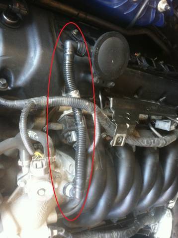

oil in the intake is normal on the LS and older engines. the 4.2 and later have an oil separator valve and it cuts down on mist in the intake tract

I might go ahead and buy a oil catch can just to have it. I drive it home from my shop today and it wasn't smoking. Until I got off the highway and had to stop at a light. Started smoking again when accelerating. I'm thinking it should clear up eventually. The new issue is it stutters when it shifts into overdrive under light throttle. It's a fast stutter. It threw codes for a misfire on cylinders 8,7,4. Plus a lean bank 2 code. Since the coils aren't cheap I want to ask you guys if you have any idea if there might be anything else that could cause this? Thanks for taking time to try and help me out. Oh the coils on it now are cheap Amazon coils.

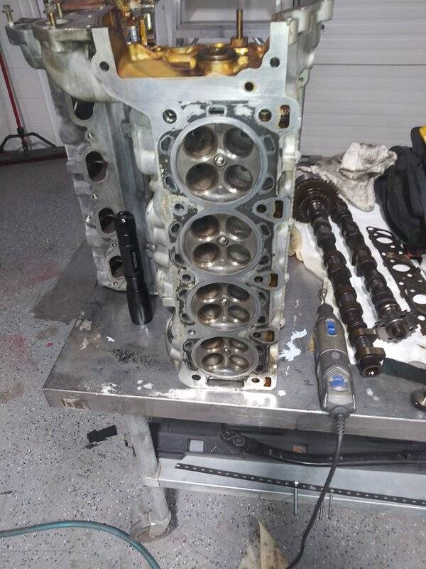

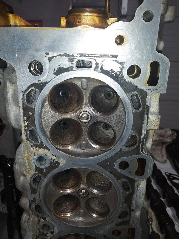

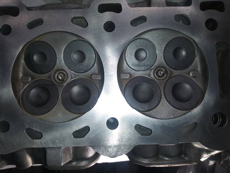

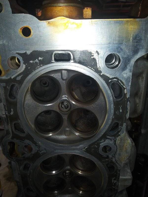

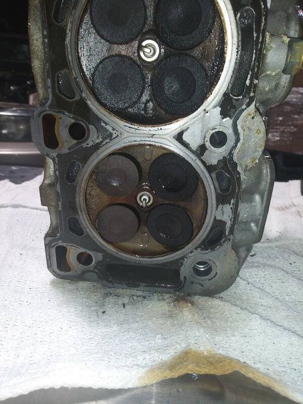

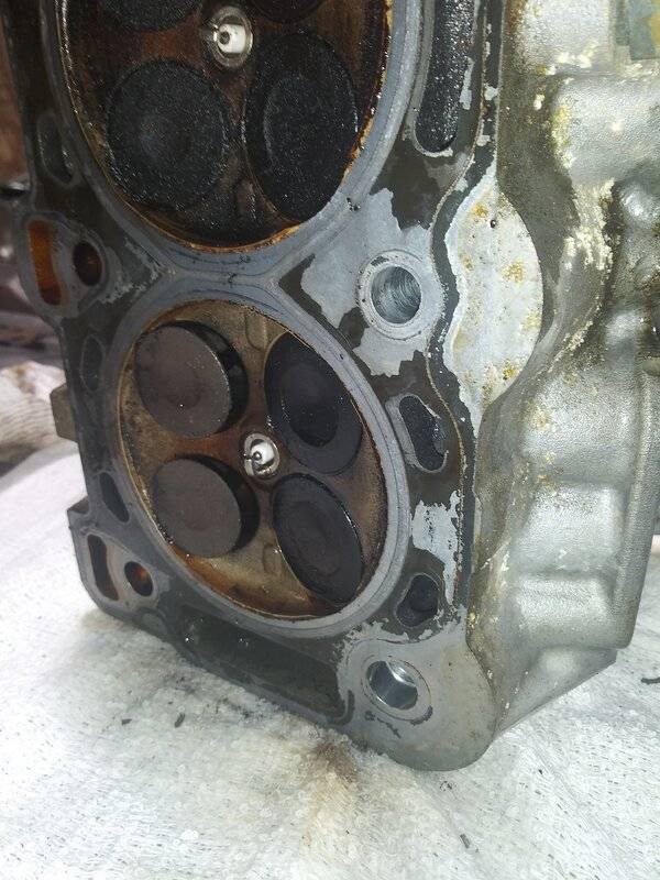

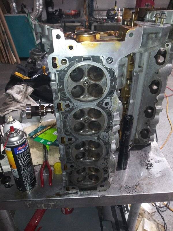

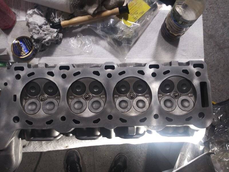

Just a thought... but maybe the bent valves damaged the valve guides on #7 just enough to cause extra oil consumption.
Take the suspect head to a machine shop and have them pull a vacuum on the intake and exhaust ports of #7.

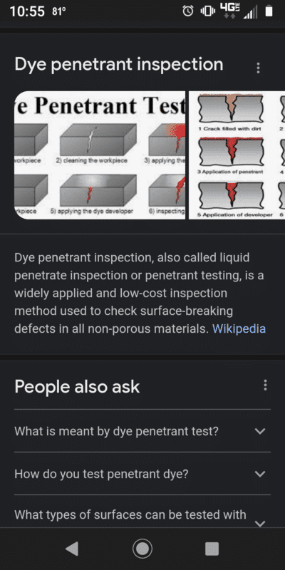

Maybe have them dye-pen the head too to check for cracks.
Maybe have them dye-pen the head too to check for cracks. View attachment 828577206
Good point. I try moving the valve side to side to see if it had more play than the others but I can see how that wouldn't be definitive answer. I should have just had the valve guides replaced when I did everything else. I can do a lot at my shop. Have a mill big enough to put a head on. I'm thinking that might be my next choice. At this point im going to keep driving it and see if it clears up. It's getting better but not completely gone. Hoping its just a stuck ring and a vacuum leak that I haven't found yet.
04_Sport_LS
Jun 12, 2012
5,183
900
Somewhere around Lake Erie
Usually you set up a dial indicator on a base... and check for lateral movement of the stem in the guide.
Depending on the manufacturer... usually determines the specs... which are found in the book for whatever specific engine.

I let a auto machine shop do it because they magna fluxed head for cracks
Magnaflux won't work on aluminum heads. That's why I suggested dye penetration.
It's an outside chanuce a bent valve stem is not seating 100% causing a lower comp psi
He replaced both bent exhaust valves... and got compression up to spec. However... the guides may still be an issue.

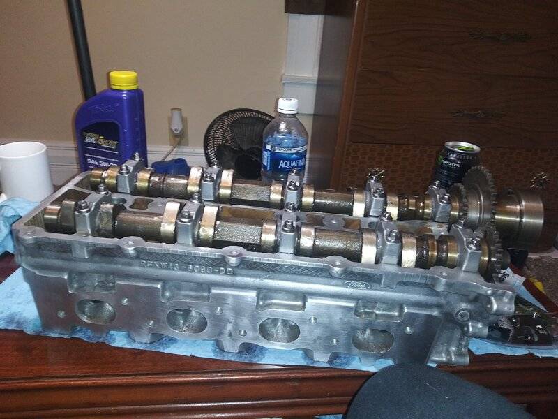

The LS 3.9 mV8 has no rocker arms. Wrong engine.

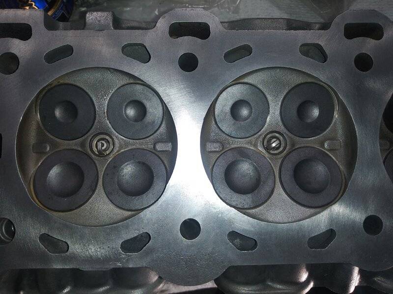

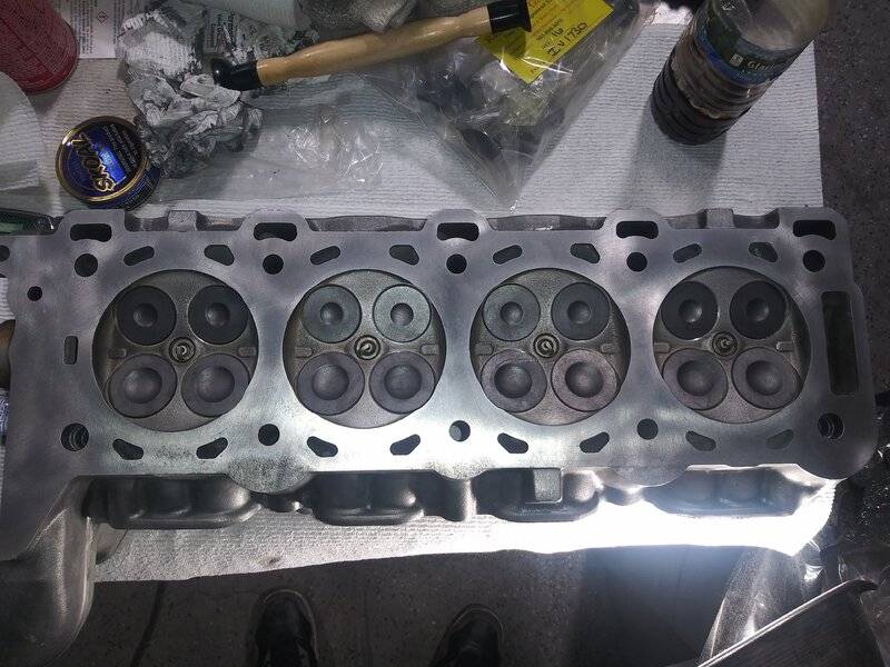

Yes all new valves. Also when I went back and replaced all the valve steam seals I used compressed air to hold the valve up while I removed the springs. So I know the valves are seating right in the head. Well against the valve seats anyhow.

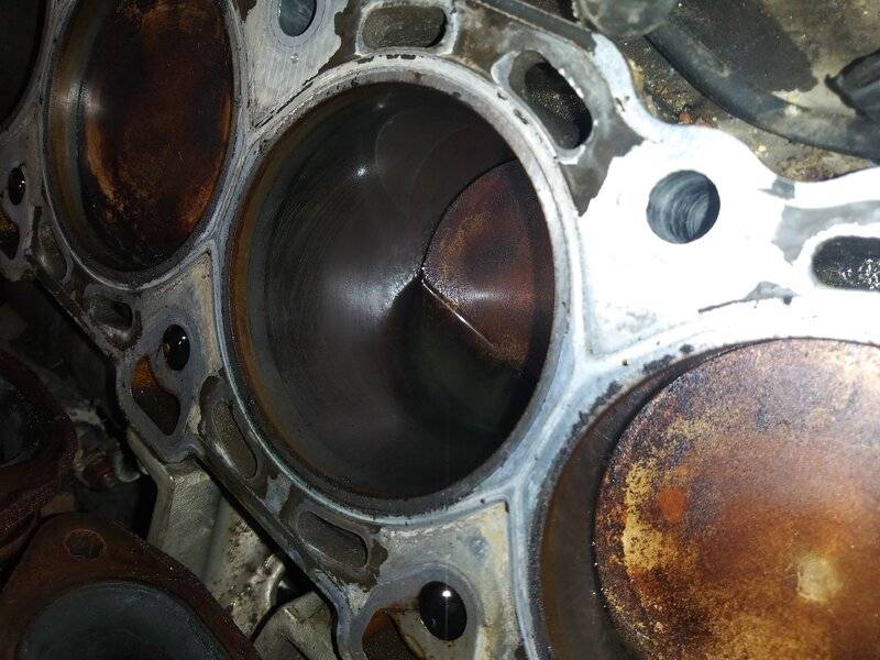

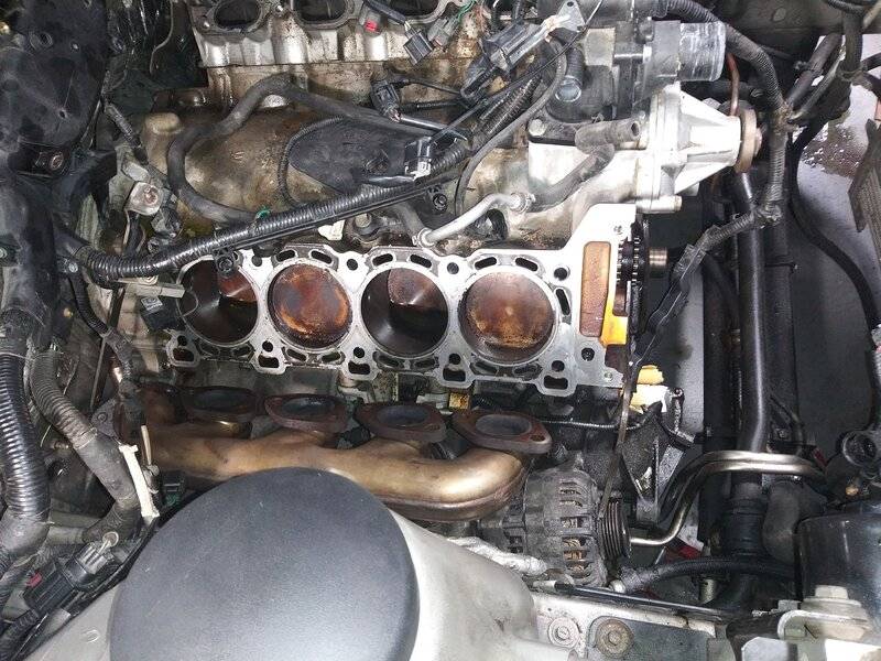

Hey guys thanks for all the help. I found out that the rings on cylinder 7 and 3 are shot. I'm going to be pulling the motor. Found one with 19k miles local to me that I was able to steal for $1,300. So a motor swap it is.

Sorry to hear that... but looks like you found a silver lining.
Thank you. Not completely sure about the motor yet. It's bought and paid for but found out that the wreck broke the timing cover and cracked a valve cover. Fingers crossed. Just have to wait till it gets here and see how bad the damage is.
