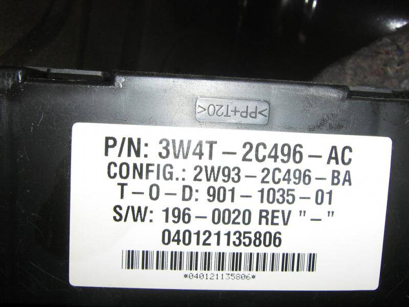

found it the Part # is different then the one on ebay could this be because the one on ebay is from a 05 Lincoln and mine is 04

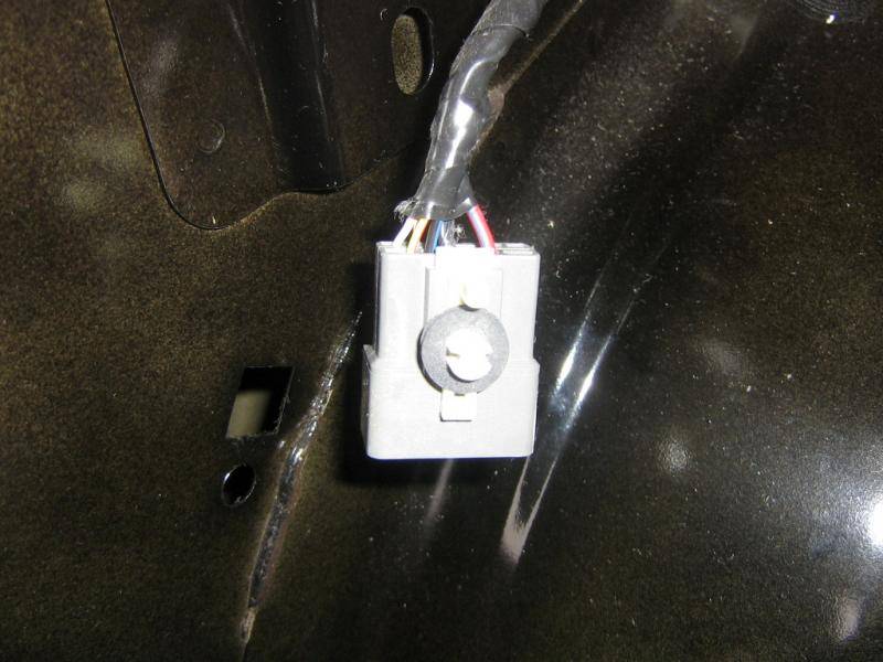

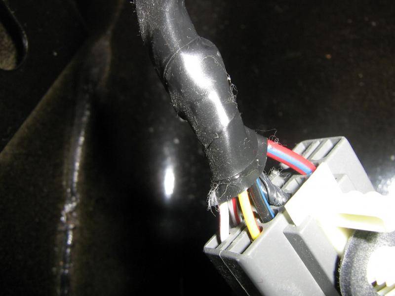

I also found this plug not connect to anything anyone know whats it's for??

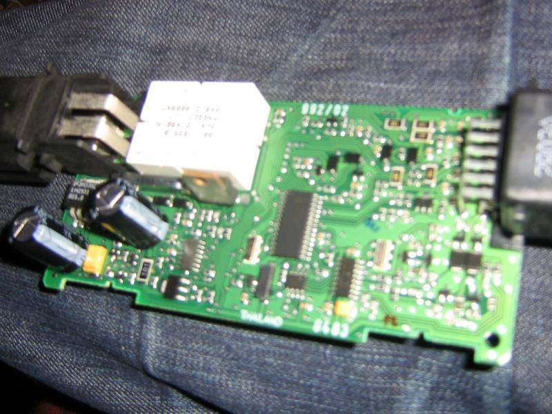

anyone tried fixing one of these before? I cant see anything wrong doesn't smell or look burnt IMG_2135.jpg
Yeah, looks like the ebay one is just a newer revision.
whats wrong with it?
its probably not bad.
when you re-connect the battery the first thing it asks on the dash is to set the parking brake. if you dont do it right then it tends to have issues like constantly prompting you to set it or it wont let you set it at all and illuminates the yellow light on the switch. also a failing dccv has been shown to cause problems with the car continuously prompting for the park brake to be reset.
i would check that first fuse in the box under the hood, bc it might be loose.
