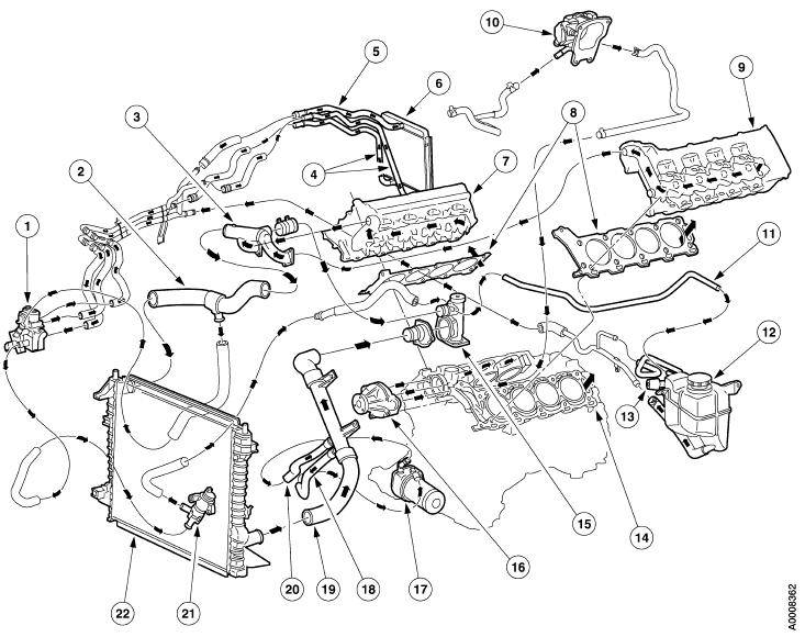

I had to 'dive' into this when I did the SC project, it is complicated...
1 — Coolant control valve
2 8260 Upper radiator hose
3 8A520 Coolant outlet tube
4 18472 Heater inlet hoses (2 req)
5 18472 Heater outlet hose
6 18476 Heater core
7 6049 Cylinder head RH
8 — Cylinder head gasket (2 req)
9 6050 Cylinder head LH
10 — Throttle body adapter
11 — Engine vent hose
12 — Degas bottle
13 — Relief valve
14 6015 Cylinder block
15 8A587 Thermostat housing
16 8501 Water pump
17 6A642 Oil cooler
18 — Oil cooler inlet hose
19 8286 Lower radiator hose
20 — Oil cooler outlet hose
21 — Auxiliary coolant pump
22 8005 Radiator
Does anyone know what the piece in front of the the thermostat housing is called. It where the lower rad hose connects into. It is the piece with the three bolts! That piece corroded on mine and was wondering if I can just buy that piece or do I have to but the whole thermostat housing...thanks guys....

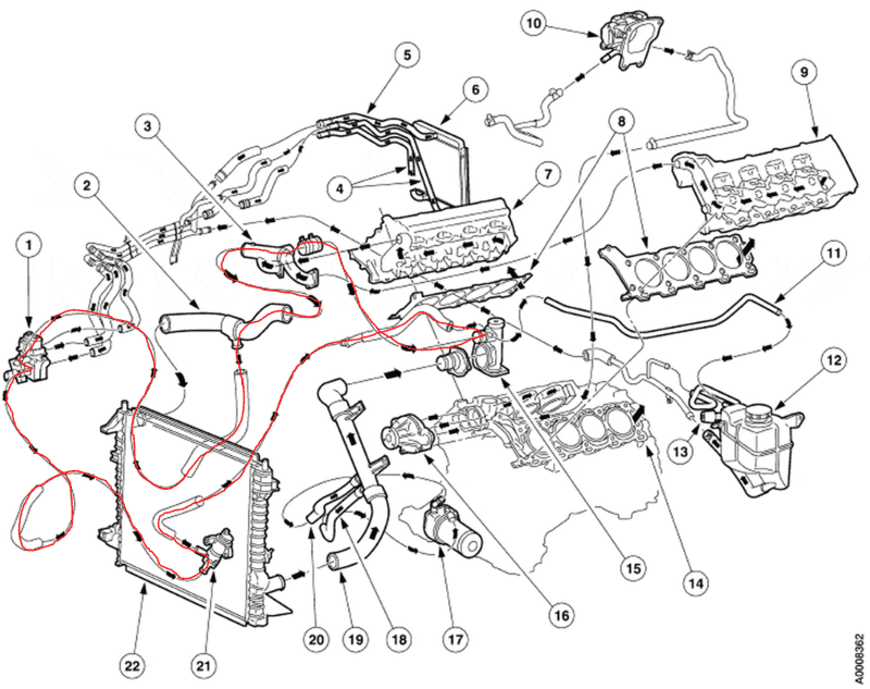

Guys sorry for hijacking the thread, but i want to ask something. The DCCV . If its not engaged i.e the heater is not switched , does it circulate the water like i marked in the red on the picture below , or is it completely blocked and not flowing at all until the heater is engaged. The reason i am asking is because i plan to switch the car to LPG fuel in the near future. To do this i need to connect the evaporator somewhere and i want to know, if the coolant is flowing through that line ,when the heater is not working.
Engaged is valves closed. The valves default to open when there is no power. When they are fully powered, they are fully closed. There's no alternate valve that opens when the two valves are closed. There are only the two valves (one for each heater core half).
Ahhh thats sad i was afraid the coolant gets blocked , when the heater is not engaged. Well i guess i have to connect the reducer in parallel instead of serial. Thanks a lot for the help.
edit:
Actually after reading this : JagRepair.com - Jaguar Repair Information Resource
I am not convinced the flow is closed on gen1 . If you take a look at the picture of the valve it seems the plunger is closing the bottom port , when it opens the ports towards the heater and is opening the bottom port , when it closes them. Basically when the heater is not working the coolan should be circulating between the input and output port of the valve.
Gen2 is another story it has only 3 ports , so the coolant is blocked for sure, when heater is off.
