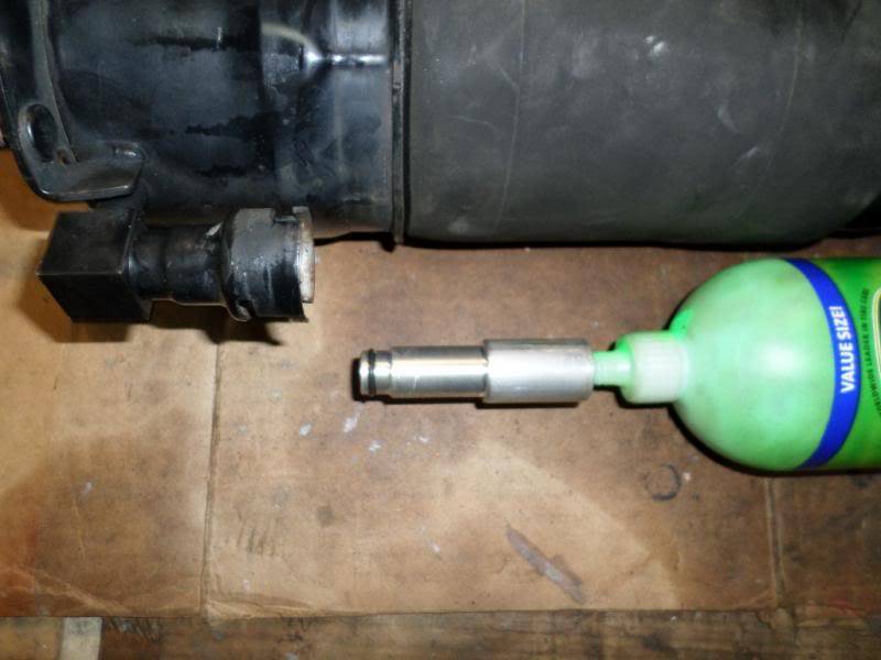

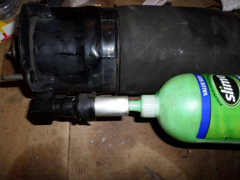

I had to do it. I think Ed is the one that got bashed for "sliming" bags??? Went to load up Red and heard hiss by drivers tire. Made this adapter to fill bag super easy.
Here I pumped in 14oz and then rolled strut around all different ways to coat inside of bag.
Car is staying "up".

There were a couple other members that finally admitted to doing it too. :)
I think the problem with Ed doing it is that he was supposedly towing stuff with gooped bags.

Yep. A couple of us have done it. Including me. I slimed the front bags on the '97 and drove it for a few months like that until I could afford new air shocks. That is a really neat setup you got there. I like it. Just make sure you don't get that stuff in the solenoids or lines. Once it's in the springs, there's not possible way it can get into the lines unless the car is turned upside down. But remember it's just a band-aid, not a repair. :)

this is fine, as long as you don't push it so far that the deteriorating rubber explodes/splits/cracks/whatever. then you got real problems!

On my '95, I got stuck on the road with one front bag dead. I used the grommet from the throttle cable thru the firewall and vacuum hose and set it up like an IV bag used in the hospital. Worked for 700 miles. Within 20 minutes of getting home, it let loose. What a mess. For $20, however, it did the job.

personally, i would use this only as a last resort to get home/garage etc.
I would never feel comfortable driving daily knowing the bags are leaking and need sealer to stay up.
who knows, it may last for 10 years, but damn, i think coil springs ride fine with the right dampers and springs
just my opinion, and i dont judge anyone here for using this fix.

I will be looking for a used replacement for sure. I shot myself in the foot I sold the good one out of my parts car. I should of had that in stock. Dooohhh

Glad to see others follow my example. So far, so good even with the towing.

The problem with Ed is hes a general dumb ass. It was far more than just sliming bags.
Now I understand in a pinch that you would need to use it. Im fine with that. Its using it as a permanent temporary fix that I take issue with. But that's just me. I feel to "fix" something you need to actually fix it and not just put a bandaid on it and call it good.
