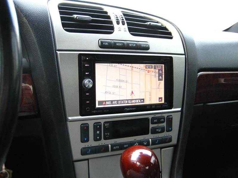

Well the a/c controls sticks out farther. In order for it to be straight it has to be angled backed. I wil show a pic wed
the climate control should not stick out further than the radio, they should be flush with each other, the climate controls should only stick out further than the ash tray

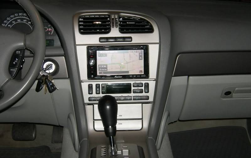

i know that these are 2nd gen pics but the issue is the same
not trimmed with gaps
done right with no gaps
also if there is too much stuff (wires and harnesses) behind the radio can also make this much worse, all the wires and harness need to be pushed off to the sides to make it fit properly, if you can barely get radio back into the hole to get the 8mm bolt in and just use the bolts to pull the radio all the way in it will push out in the center
