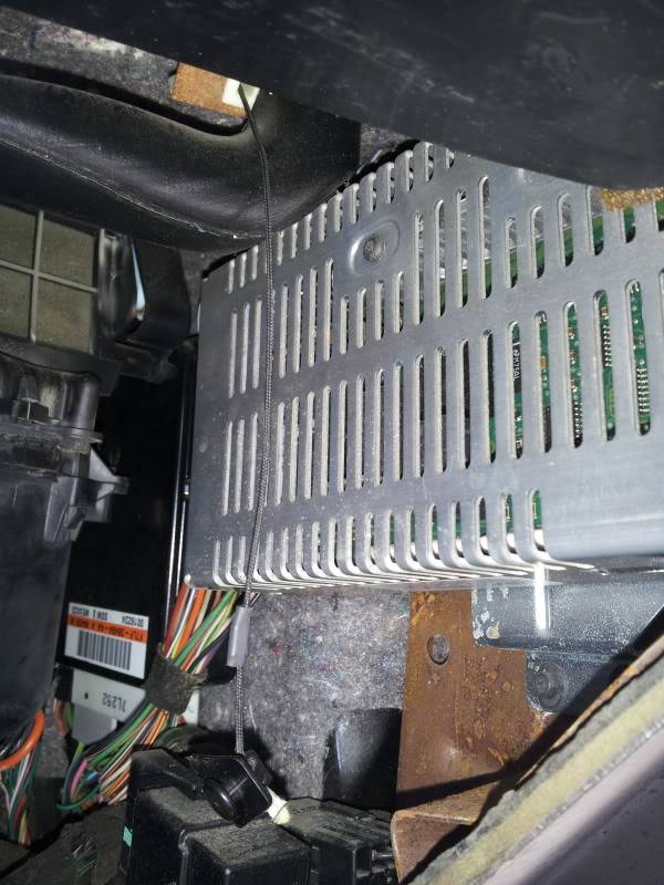

I don't need to be alerted that my door is open, nor that my key is in the ignition..
Someone know where the chime is so I can DESTROY it?I've hunted all under the dash, and looking for it is just giving me a headache
Found the noisy bastid, thanks
Now, can I snip a wire to only eliminate the chime, or do I need to open up the module and snip the solder?
if inford wasnt being so gay i could tell you, if you have any other requests for hard mark stuff just ask, I have my own log ins for fords online service website.

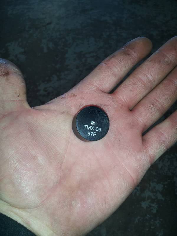

Just took the case apart and identified the chime on the board, gotta desolder it since I can't find a wire schematic specifically to eliminate it by itself
Not sure about a Gen 1 Terry, but the Gen2's is behind the glove box on the right, inside a module box, I'm guessing its the Light Module?? Had to heat the solder and it came right off the board
