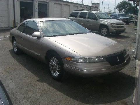

This is how the car looked when I first saw the car at Jamie's place like 4 years ago. The story as I understand it was that a customer brought it to Jamie to fix it up because he wanted to sell it. Matt, the guy that works in the shop with Jamie decided he wanted the car, but I think the car had snowflakes on it, and they threw 10 spokes on it. Matt decided to buy it for his wife to drive. Later after, the trans took a dump and only had 1st and 2nd gear. She, I guess figured that once a car breaks it won't be right again and she wanted a different car to drive. I think I was at Jamie's picking up som parts and Matt asked me if I might be interested in trading for the 94. I had my SHO at the time and he was interested in that, but his 'ol lady wasn't comfortable driving stick. I talked to my wife and asked her if she was interested in trading, she said lets go check it out. I found out later, my wife didn't really want the car, but she knew I did, so she agreed. We traded a really nice (imo) 97 Taurus with the 24v motor and the suspension was upgraded with SHO parts, the sucker would really handle. I can't find a picture of that car :(
We drove the car from Tampa to Orlando with only 1st and 2nd gear, that was fun, but I shortly after installed a trans that I bought from Jamie that was intended for my 97. It is J-modded now with updated springs and a new accumulator piston.
These are pictures after I got the car.

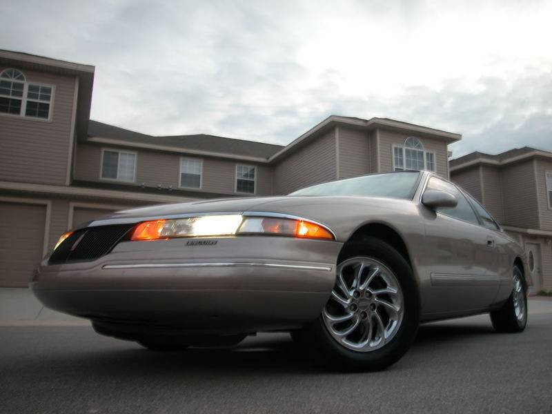

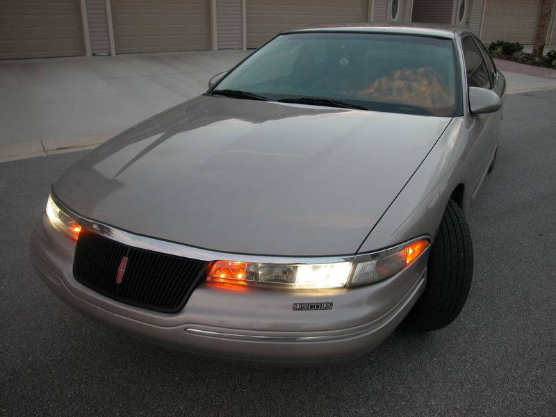

I installed a set of DDM tuning HIDs in 96LSC housings in the High/Low position. I don't have pictures of the install but here is the day look.
Thru the grille you can see the ballasts.

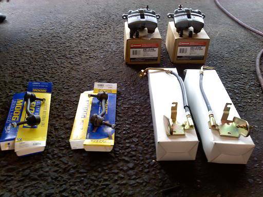

Car also got a front brake overhaul with new pads and sway bar links.

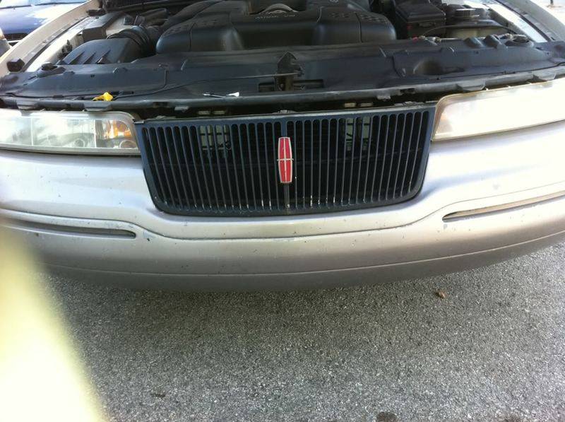

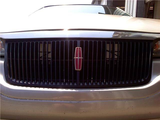

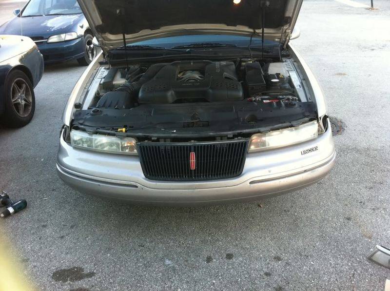

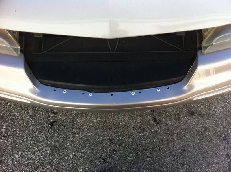

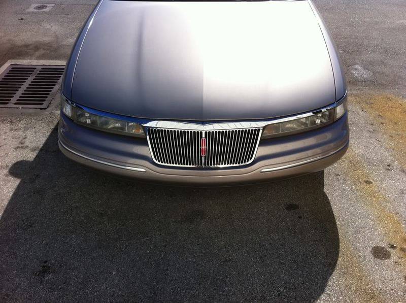

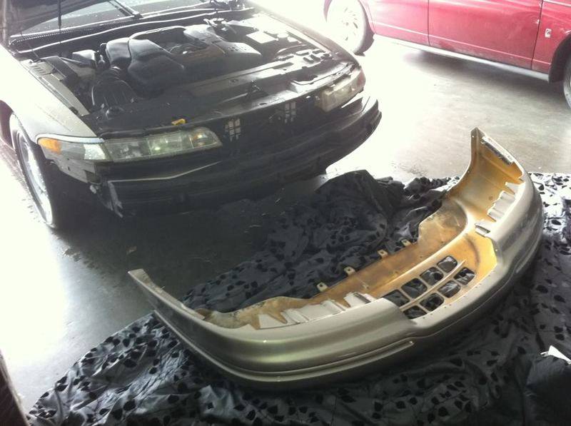

The most recent updates to the car is the new front bumper, grille, and chrome trim. This is the car the grille and bumper cover came from.

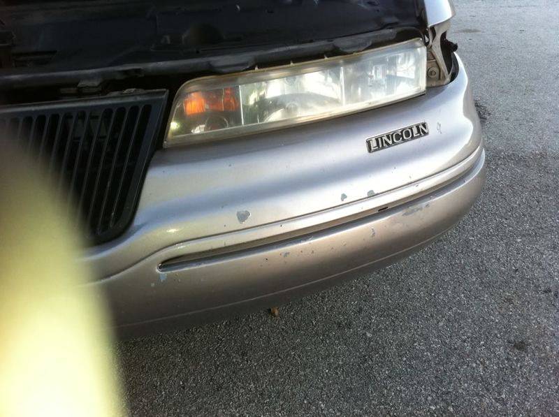

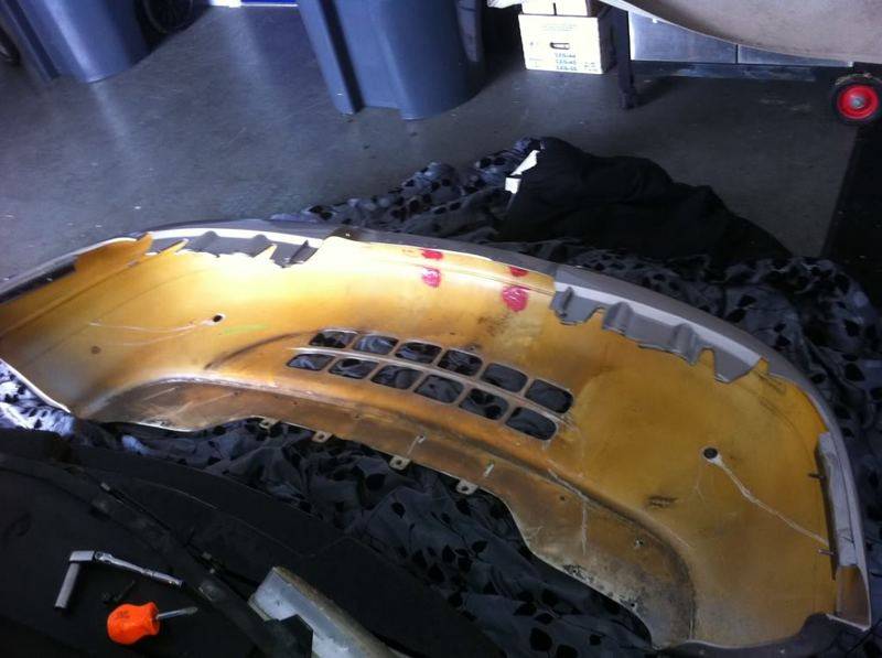

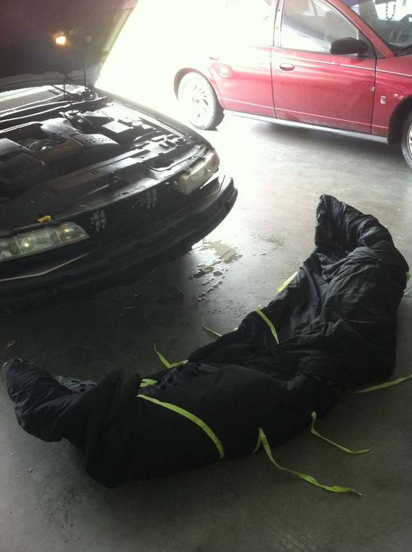

The front bumper was chipped up really bad, and had been repainted with a single stage paint before I bought it, so the chipping was worse than normal. The bumper cover was redone in base/clear and the license plate bracket holes were filled, and the indent for the Mark VIII emblem under the driver light was filled. That bumper was painted about 2 days before I moved to FL, so it got wrapped up in a comforter and I put it in my friends garage. Finally got a wild bug up my butt to install it.
Before:
During:
Rear --
After:

A grille really does a lot to make the car look better. I just hope mine stays nice for many many more years.

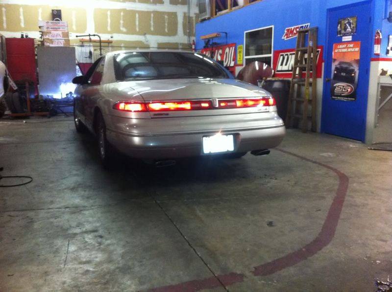

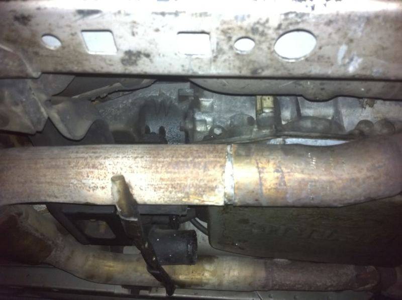

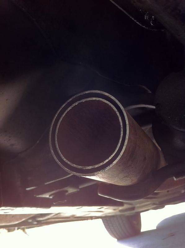

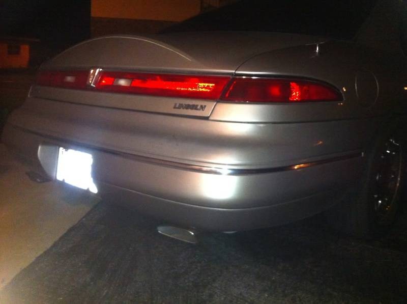

I had been contemplating adding all of the pictures today, but it took me long enough just to get all of these pictures together. I need to take some more/better pictures of the exhaust. Ill go out right now and take a pic of my exhaust repair. Im cheap and OCD when it comes to my car and didnt want an exhaust shop work on my car, so I just did the repair myself.

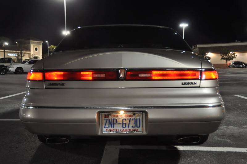

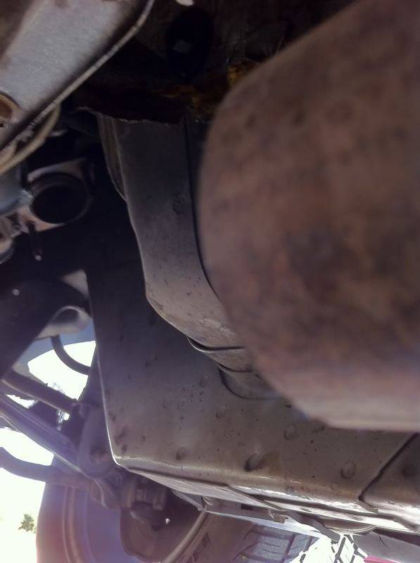

To those that didn't know, the passenger side cat on the LSC exhaust was cracked when Jaime and I installed it. We lobbed my old cat off and threw it in my trunk until a couple weeks ago...
The pipe fits so tight that it doesnt need any clamps or anything. I'm just going to get it welded. The coupler is 4" long so it is very sturdy.

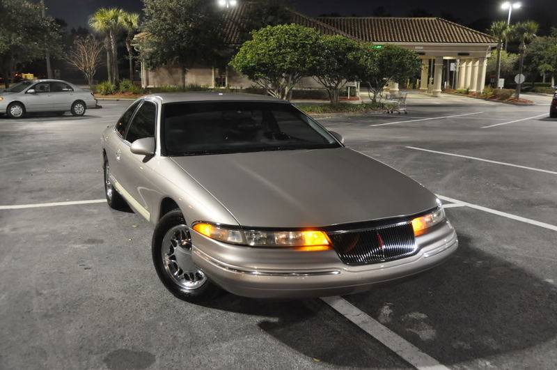

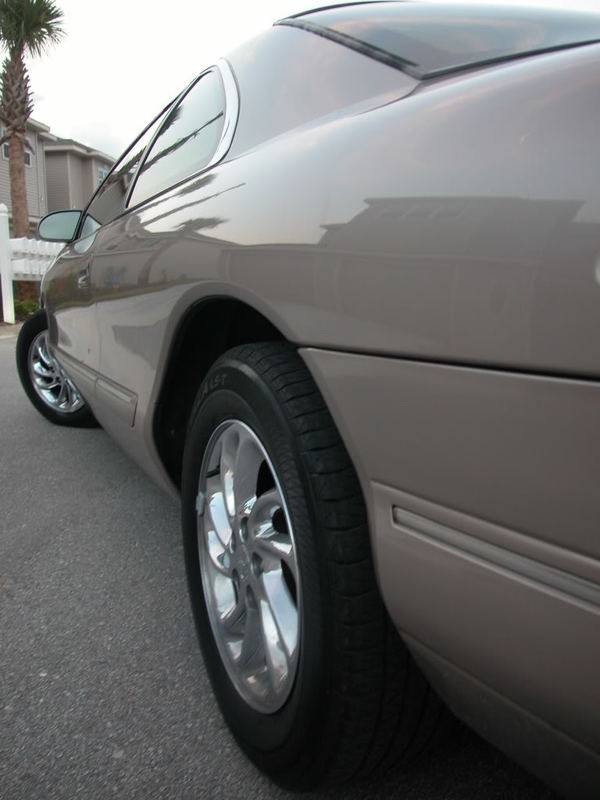

Washed and waxed the car today. It was 78* in my neck of the woods today. I gotta give props to my wife, she waxed and I followed with a micro fiber towel. The pictures are kinda lame, it was just too damn dark. I will get some nicer photos as soon as I can.
Weird Picture...
I really need to paint the side trim on the car, but still haven't looked into finding an aerasol can with the paint match. The pix mainly just show how nice the chrome and paint is... ENJOY!

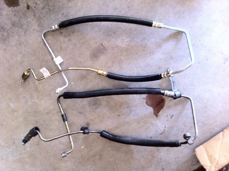

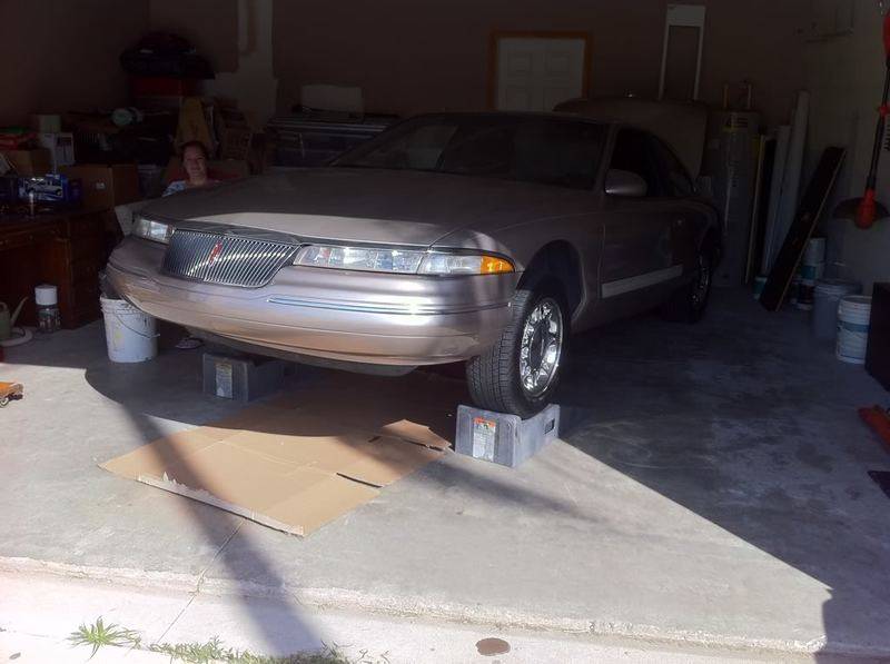

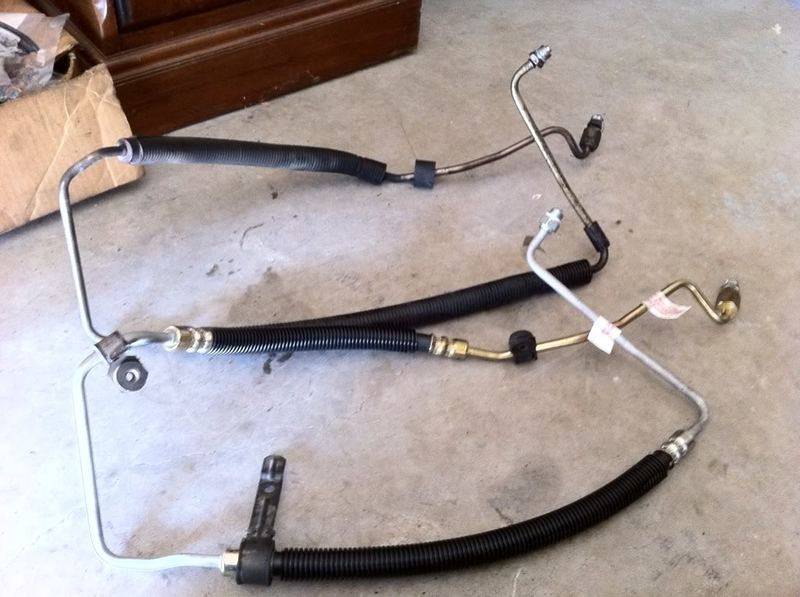

Had to replace my powersteering pressure line today. I believe what happened was the o-ring inside the fitting let go. It was leaking from between the fitting and the line profusely. I lost all of my fluid within 5 miles when I drove it home the other night. It sat until yesterday when I picked the hose up at PepBoys for right at 30 bux.

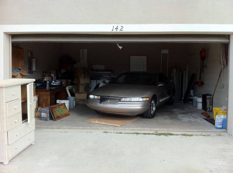

The house we are in right now is a rental, and we have only been there for about 2 months so I had to clean the garage up a little to get the car in there without anything too close to it.
I popped the height sensors off and let the car pump up, then shut off the AS switch to keep it at a higher position. Then put the ramps under the front of the car.
Brought a bunch of my tools home to do the job...
Hose before I swapped the retainers.
After the retainers were swapped.
And lastly, I always am an advocate of wearing nitrile gloves when you work... If the phone rings, or you gotta take a piss, 3 seconds to whip the gloves off and you are clean. Here are my pretty hands...
System didn't take any time to bleed, and it is back on the road. UPS shows my trim paint will be here tomorrow evening, so hopefully the next pictures I post will be of the door mouldings finally painted...
