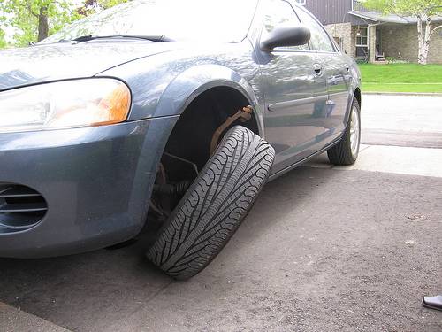

    Here's what a broken ball joint looks like... Lower: [​IMG]
    Upper: 2522549289_2259e8e397.jpg
