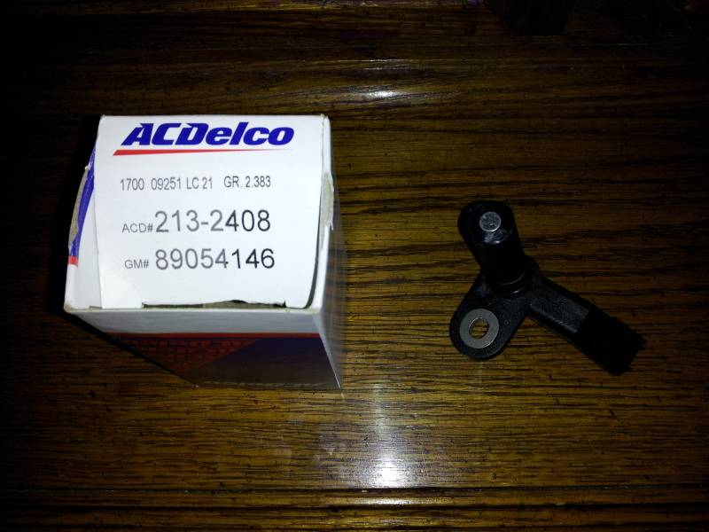

Chris, I got this one from AZ a couple of years ago for the 94 but never used it. Unless you want Motorcraft, they do carry them there but are AC Delco

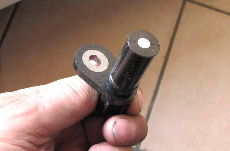

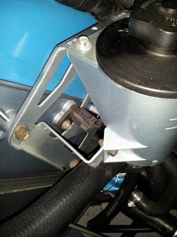

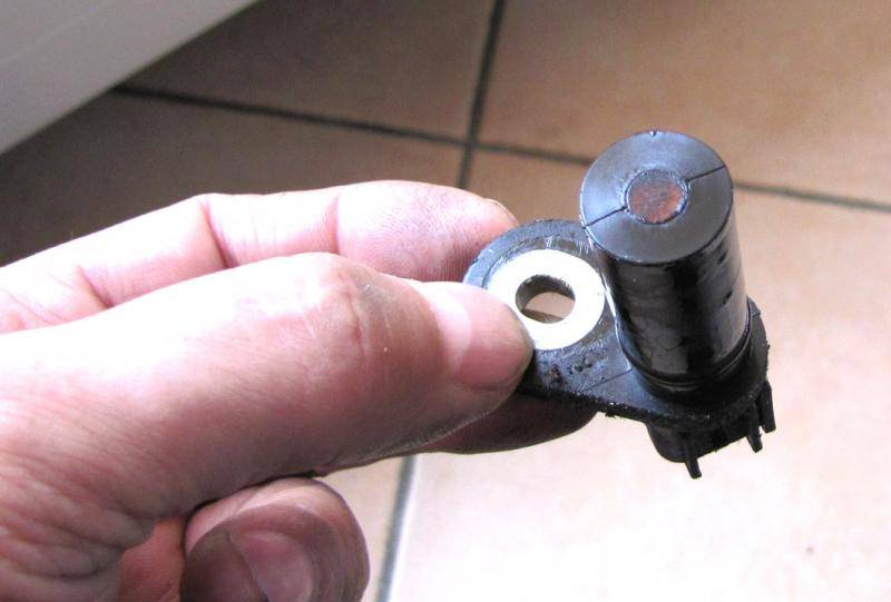

Hi Chris and NoLimits,
have you please a foto for me, from the position at the cam sensor ? I think, my sensor is dirty.
Thanks im Voraus
Dedalus
The cam sensor is located in the left side timing cover, behind the power steering reservoir

So basically the cam sensor does not matter? The car starts well, if it is defective? - Then it can not be with me at the CAM sensor. Tomorrow I try to change the crank sensor.
PS.Thanks for the foto with the position - a very clean car - very nice.
sry. i translate with google ;-)
