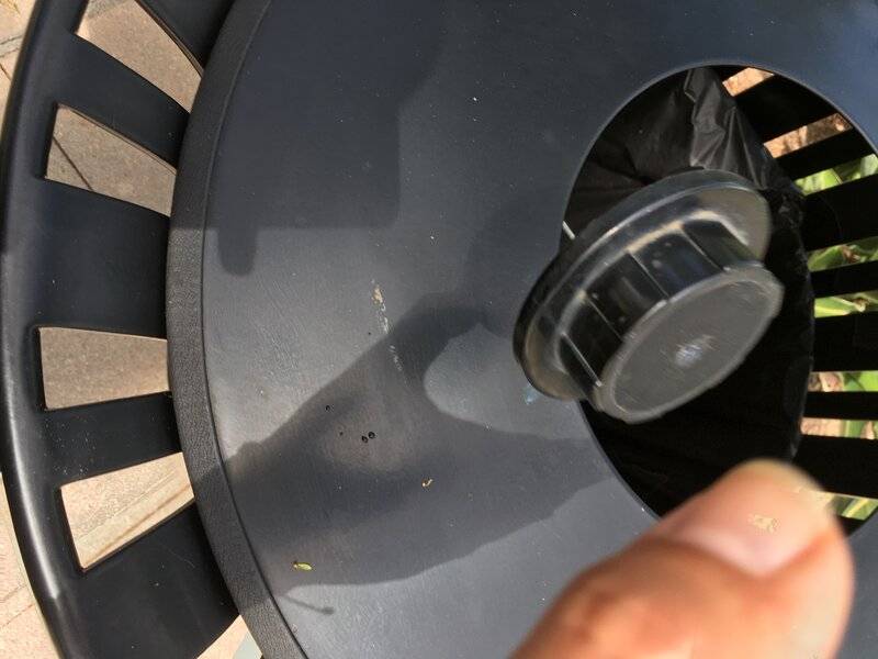

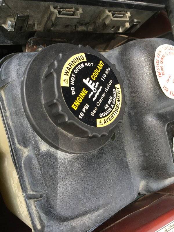

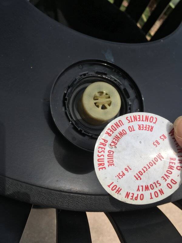

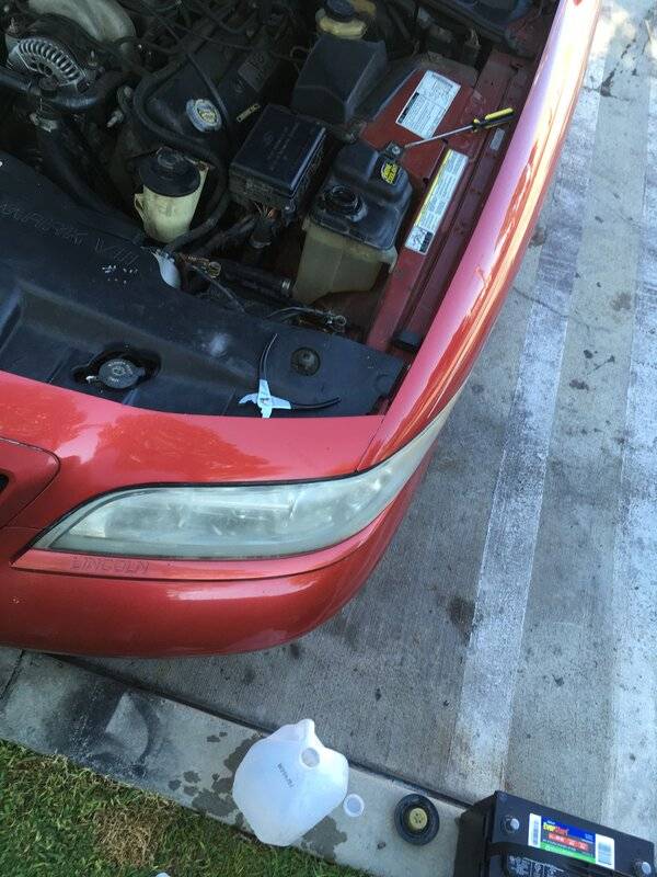

Your so right I had a cap issue here me throwing the caps that tend to leak in the trash because that cap causes my 97 to overheat way more... althought when I pulled my new resivor it was from a first gen and came with this cap... learned the hard way these loose strength and can’t hold pressure ...the last pic you see is the cap you want ... the caps that ,clicking, sound when you tighten them enough
