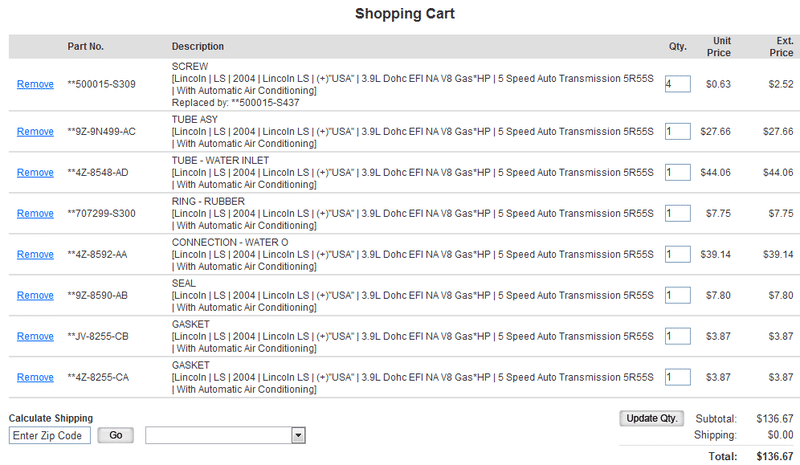

This is where I am so far... parts, gaskets, and replacement bolts if I need to do the cut method with the elbow:
Unfortunately, fordpartsgiant.com doesn't list an expedited shipping method for me so I'm trying to contact them about it. I really need this car fixed, preferably in the next few days.
You need two of the 8255A gaskets, but I'm not sure if that's 8255-CB or 8255-CA. (The gaskets are often reusable anyway.)
I'll likely just end up reusing any gasket I don't have a replacement for. I just figured since they're not that expensive, wouldn't be a bad idea to buy new ones since I'm already going to be digging in there.
