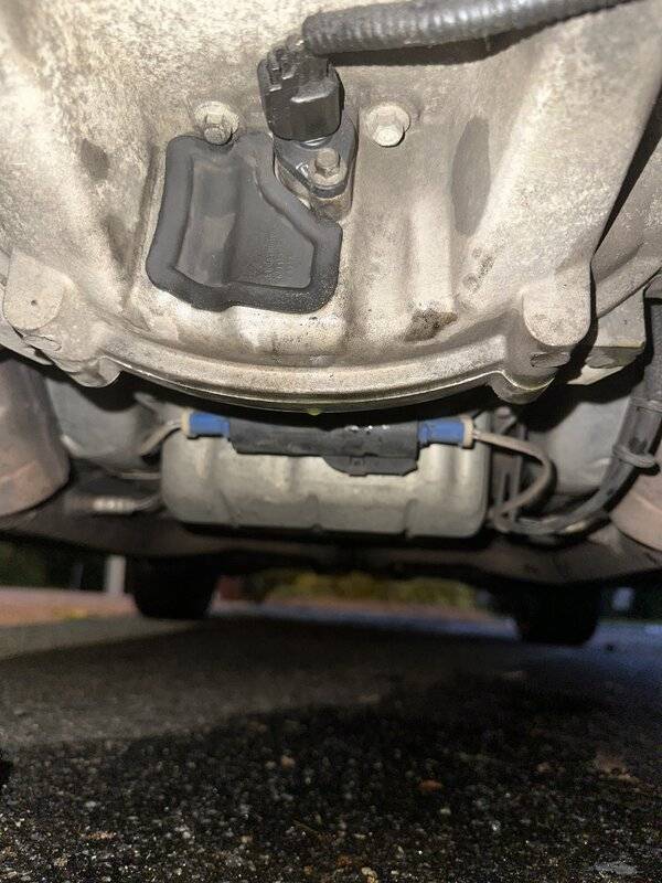

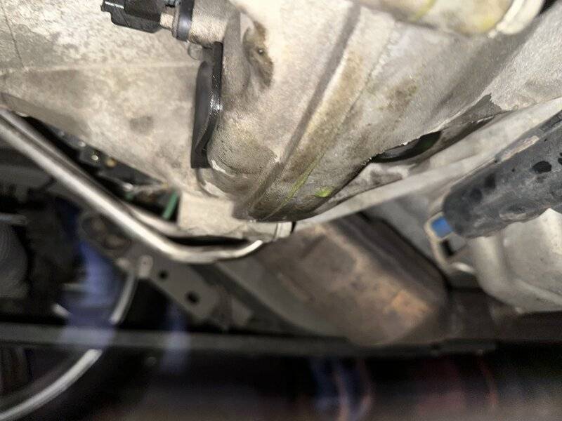

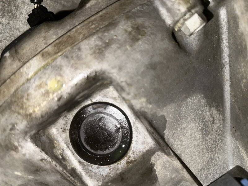

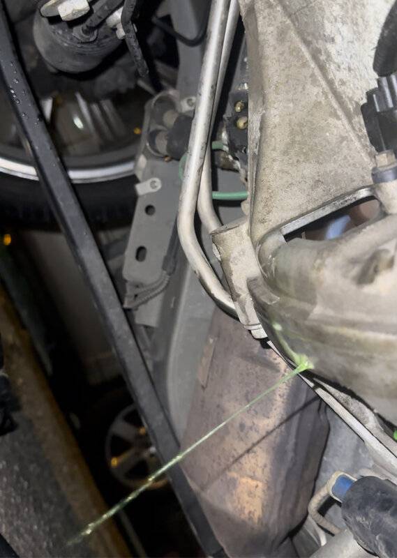

I recently replaced my upper intake manifold on my 2001 Lincoln ls v8 and as soon as I put everything together I noticed I had a pretty bad coolant leak coming from out of the bellhousing, I did not have this issue prior to replacing the intake manifold and have not driven it since.any idea with what’s going on?
Pressure test the coolant system with the engine cold and see where it's coming from?
It’s coming from inside the bellhousing I have a video
No, it's not. It's coming from the top of the engine and running down into the bell housing and back out. There' no coolant in the manifold, so it's not there. It's going to be one of the coolant hoses (don't forget the throttlebody heater hoses, one is under the manifold), and/or the outlet tower (where the thermostat is).
Okay thank you I’ll double check the hoses was going to have it pressure tested tomorrow!
