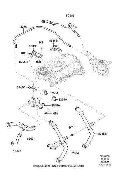

It appears the leak is on the rear passenger side of the engine.
There are a couple of hoses that run around the engine and head to the degas bottle.

Your leak is coming from the plastic cooling system parts at the front of the engine. It doesn't matter which one, they will all have to be replaced. You are not the exception to what nearly all the rest of us have been through. The coolant leaks from the parts in the front (probably 9N499 or 8548A in the diagram) and pours onto the top of the engine. It then runs along the top of the engine under the intake manifold until it pours out at the back. The Dorman bottle is a waste of money.

Okay thanks is it just basically everything that's plastic in that diagram shown above?

There's a good thread on here (created by SoulSoak) - search for it - it has every part number, price, location, and pics of how to change them for all of the cooling components maybe with the exception of the radiator.
Thanks ill check it out, I appreciate it.
The best prices that I could find were at Tasca Auto Parts. Degas Bottle on Ebay (tasca) was about $150 and includes both hoses.
The difficult part (for me) in dealing with Tasca is they don't or did not list the right part numbers. FordPartsGiant was about 10% higher in price, but listed the parts numbers.
Upper radiator hose. 8260 - 2W9Z-8260-GB
Lower radiator hose. There is a long plastic section in the middle. (w/ Oil Cooler): 8286A (KM-4677) - 3W4Z-8286-CB
Hose Under Intake Manifold: 8548B - 4Z-9F814-AC
Hose: 8548C
Hose HVAC Heater Hose (Upper Hose to DCCV): 18472 (KH-166)
Thermostat housing. This is the part with the thermostat twisted in, the fill cap,... Also called Water Outlet: 8592 (RH-134) - 4Z-8592-AA
Thermostat: 8575 (RT-1163)
Engine Fill Cap: 8A511
Plastic Elbow (underneath intake manifold): 9N499
Main Plastic Body: Attaches to the Plastic Elbow (backside) and, the T-Stat Housing attaches to it (frontside): 8548A - 4Z-8548-AD
Top O-ring for the 9N499 to 8548A HR1 - 707299-S300
Bottom O-ring for the 9N499 to engine block 8255B - 4Z-8255-CA
The 2 O-rings from 8548A to front face of engine block 8255A - 96JV-8255-CB
Large O-ring from 8548A to 8592 8590 - 2W9Z-8590-AB
Intake Manifold Gasket 9439 - 9Z-9439-AA
Degas bottle. (Need hoses) 8A080
Belt Tensioner 8676
Serpentine Drive Belt 8620
