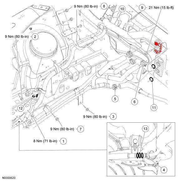

Are you talking about the AC manifold? (The part with some red coloring in the diagram.) If so, then that's just condensate water from the cold AC lines and not the source of your leak. That would explain why the pictures show clear water and not green/yellow/gold coolant.
This doesn't appear to be part of the heater core and I really have no idea what the part is
http://i.imgur.com/emdou.jpg
Yep, that's the end of the "Thermostatic Expansion Valve Manifold and Tube Assembly." This is part of the AC refrigerant loop. The water is just condensation from the air because of how cold the AC pipes get. It's just like a glass of ice water "sweating."
