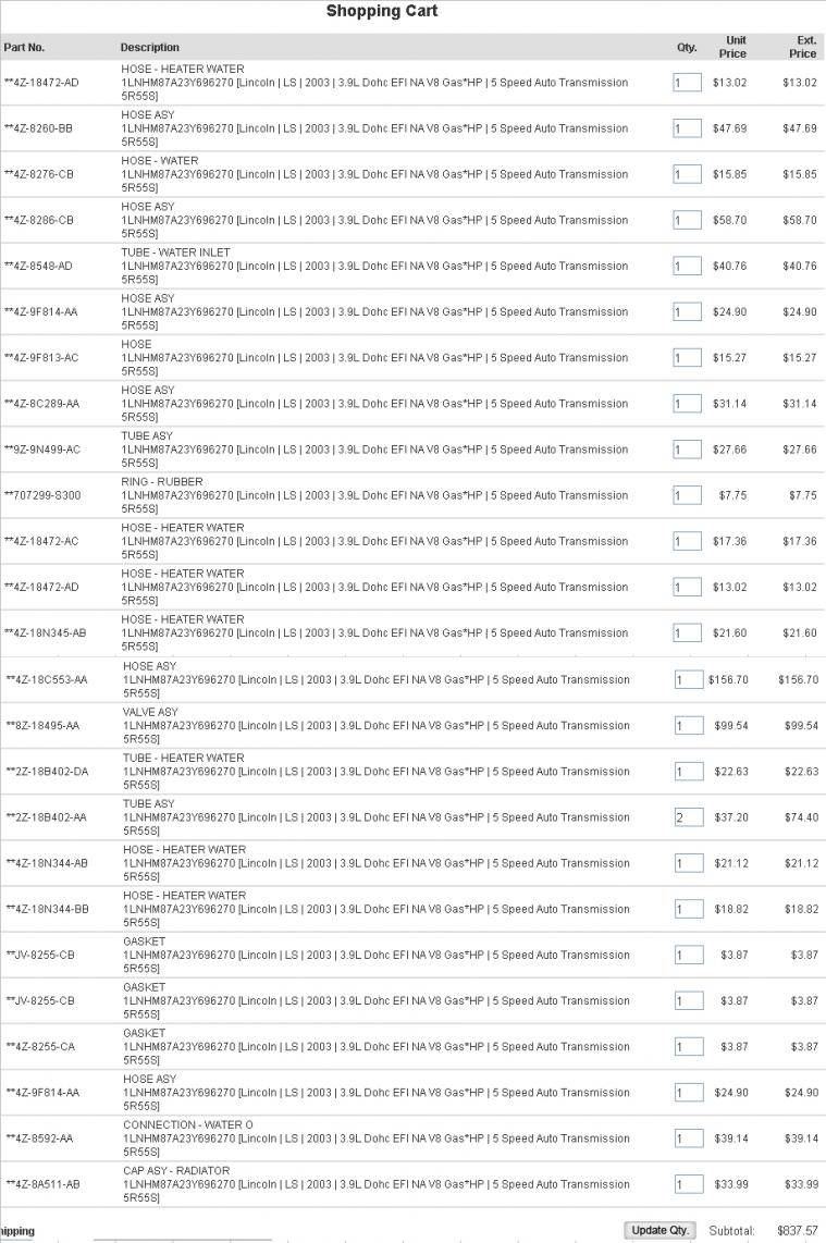

My wife's '03 LS with almost 100k just had an overheat on her way home so I went and got it drivable and back. It turned out that a small hose off the top of the thermostat housing popped off, not the normal break in a plastic part.

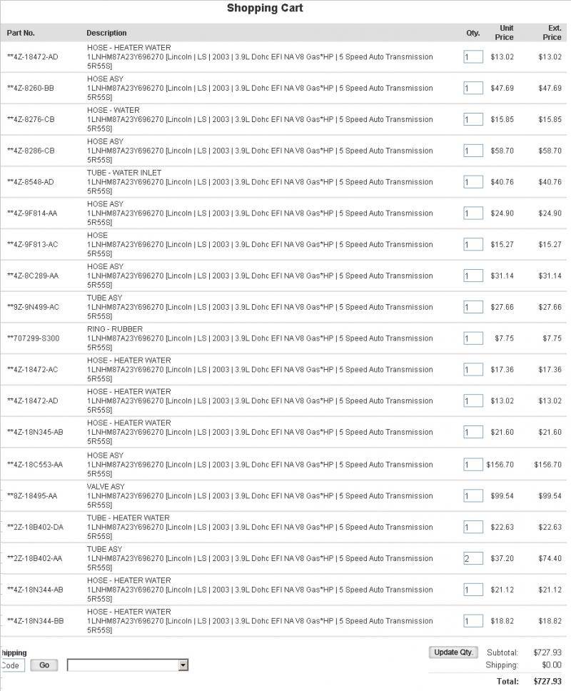

But considering the warnings on this site of plastic system parts breaking (I previously bought a surge tank and T/S and have those in storage), I thought it would be a good time to just replace all the hoses and DCCV due to the mileage. :eek: Man, this ain't no '65 Mustang 289! :eek:
I can better these prices by a few percentage, but it's still over $600.

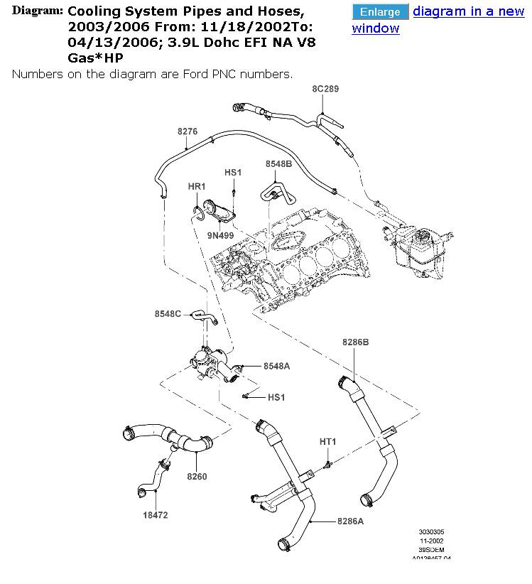

It doesn't look like that little 9N499 elbow is going to be fun under the intake.
It adds up quick doesn't it...

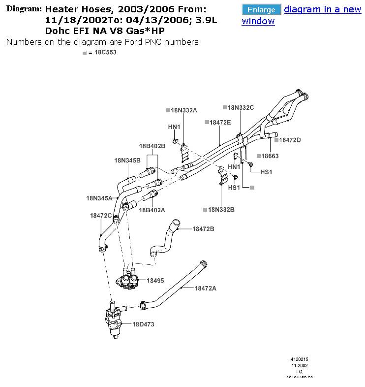

What's the expensive 18C553 part? (I don't see it in the diagrams)
It's the 3 hose package to the heater core rather then individual hoses. Shown as combined items in the heater hose diagram with a gray rectangle at each basic part number.

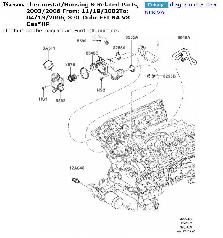

... It turned out that a small hose off the top of the thermostat housing popped off, not the normal break in a plastic part...
Yeah, that's what I thought when this happened on my 04. What really happened was that the top part of the nipple that the hose goes over broke off and remained in the hose. It looked like everything was okay, but there was nothing to keep the hose from popping back off again, except for putting a tighter clamp on. This, of course, didn't matter much because the another part of the plastic cracked soon after.
Take a closer look at the hose and the nipple it goes on.
I will Joe, but I think you're right. When I did that I remember wondering why they didn't but a swage on the end.

The 9N499 elbow is a bit of a pain, but it can be done without removing the intake. The bolts were way longer than they needed to be, so I had to pry a little on the plastic intake to get them in/out.
So far I have about $600 wholesale in plastic cooling system parts. The parts that leaked were the upper radiator hose then the surge tank, then the 9N499 elbow. So far I've changed almost everthing but the DCCV.

8592, 8548B, and the dreaded 94N99. Intake was removed for this one.
Also replaced the degas, all gaskets for the above parts and the caps. Left the rest of the system alone and it was filled and bled with motorcraft gold coolant. System seems to be holding pressure well, fan is nice and quiet at both idle and high rpms and barely any louder with the ac on.
