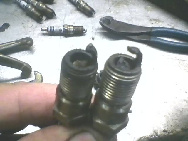

I remembered when those platinums first came out. They were supposed to be so superior and last 100K+ miles. We have replaced SO MANY of those plugs in regular tune ups where there is literally NO TIP LEFT. I'm gonna go look if I have some pics somewhere......
Oh, here they are! Check these out ladies & gentlemen:
To answer the OP:
Check your fuel pressure first. You might have a pump dying.
those are platinums?
Yes they are; same as the ones laying on the workbench in the background. I can't remember the brand right now, but I'll edit this post when I do.
Those are quite crispy! :lol:
This was #4 on the Crown Vic. No wonder it had a missfire. :lol:

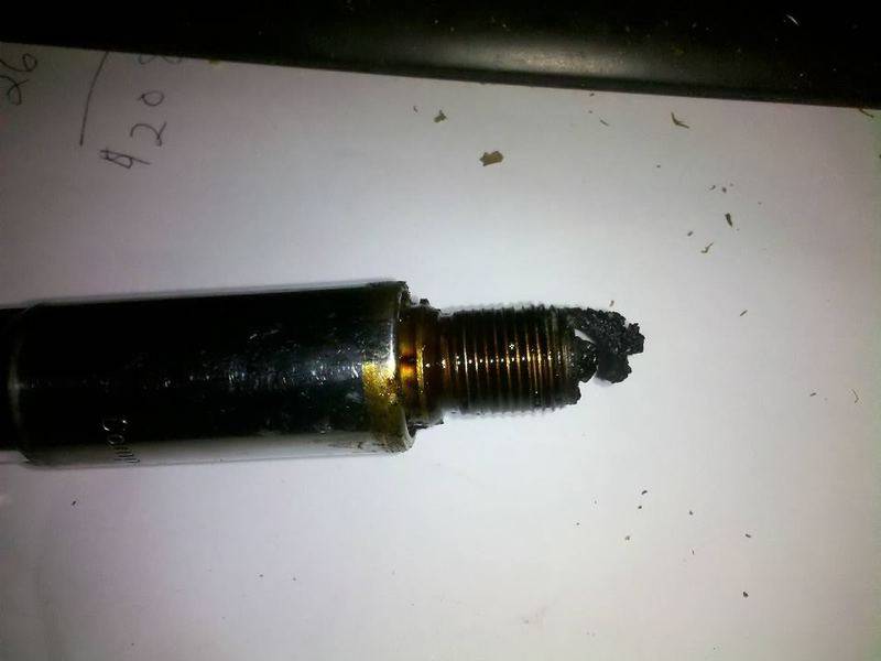

Ooh spark plug pictures. They look horrible.
Here some motorcraft plat plugs that came out the rear head of my 99 SHO when I had my cams welded. No wonder the cat basically ate itself from the inside out :D . The plugs had 162K on them :eek:
