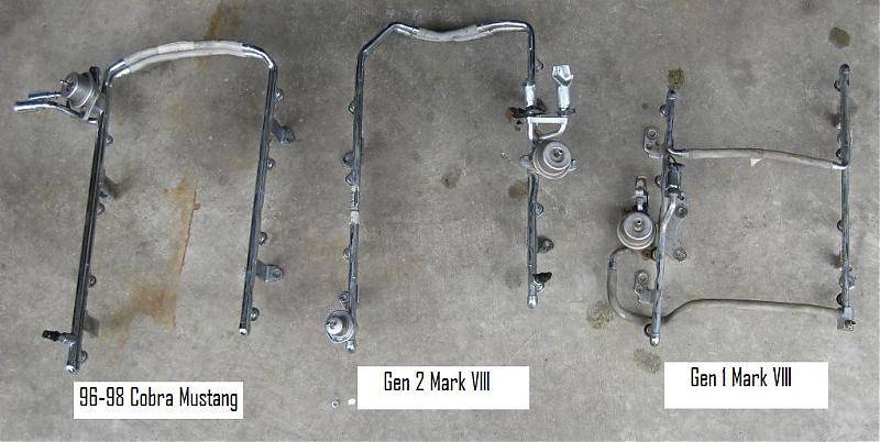

If I got the Cobra fuel rails is it pretty much a direct swap for the Mark VIII rails?
For the fuel rails I'm not really sure. I thought the fuel lines hook up at a differrent location. And the vac line to fpr and Pulse modulator would have to be rerouted.

98LSC32V I'll go snap a pic of the Cobra rails next to a gen 2 Mark rail in about 30 minutes after I shower cause I smell like diesel... ICK!

The only problem is that the lines come out on the wrong side on a gen 2 to use the Cobra rails. My plan is to use the Cobra rails with first gen fuel lines... but if you are deleting EGR (silly...) then just use the Mark lines and grind the EGR fitting...
Hell if I were deleting EGR I cut the whole "nub" off the intake and weld the hole shut... it would look freaking clean...
