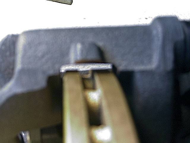

Just thought I would pass this on while I am building up the knuckles with the bracket mod on my 96 Mark VIII. The brackets are nice and worth the money.You can make them yourself but whats your time worth.I have a pretty tight tolerance with regard to the rotors passing through the caliper mount.I need to take about .060 off the diameter of the rotor to ensure enough clearence.So if you are looking to perform this mod be advised you may need to take down the OD of the rotor for your car as well.Just wanted to contribute to a great site.:shifty:
You don't take material off of the rotor, you clearance the caliper brackets! :eek:
http://home.comcast.net/~dlfraleigh/Article.html
I wrote that article and designed the brackets that Ed sells more than ten years ago. :cool:
You'd think that people might actually read my instructions, as Ed posts them in every thread he sells the brackets in. :confused:

But seriously....you have basically negated the brake mod. You took an 11.65 inch rotor and turned it back to basically stock....:shifty:
What I wrote was .060 or sixty thousandths or roughly a 1/16 off the od.:shifty:back at ya.
