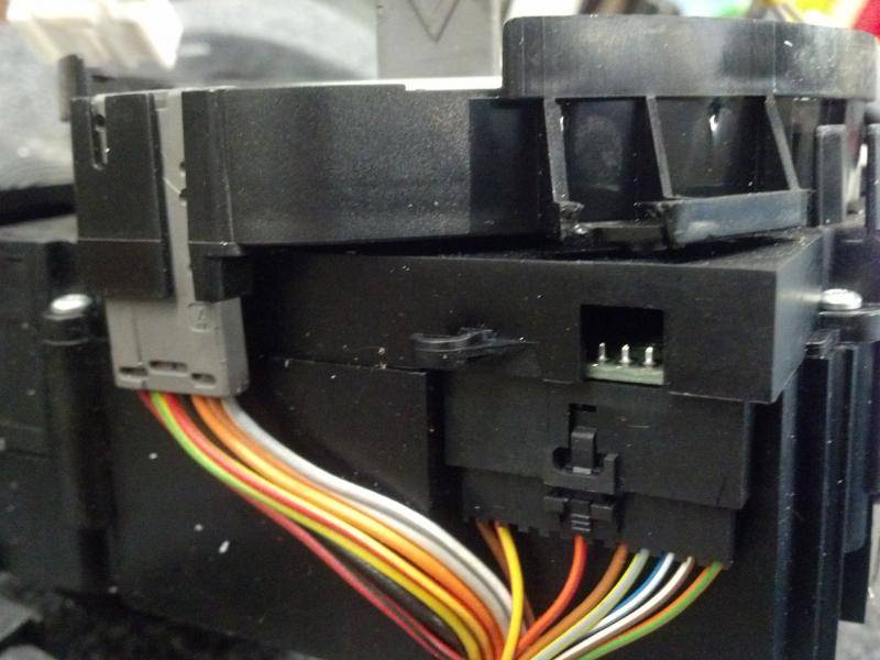

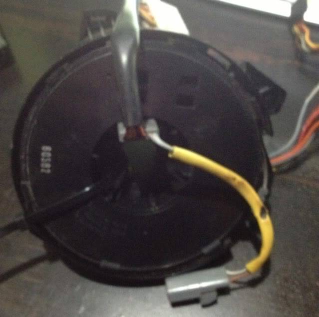

All 7 wires ohm out.
One mounting tab is broken pic 1
Chunk missing from ID (my fault) pic 2
Need a pic to make sure i put the cover back on correct
it was already half off so I'm not sure if i have the ribbon in the correct place.

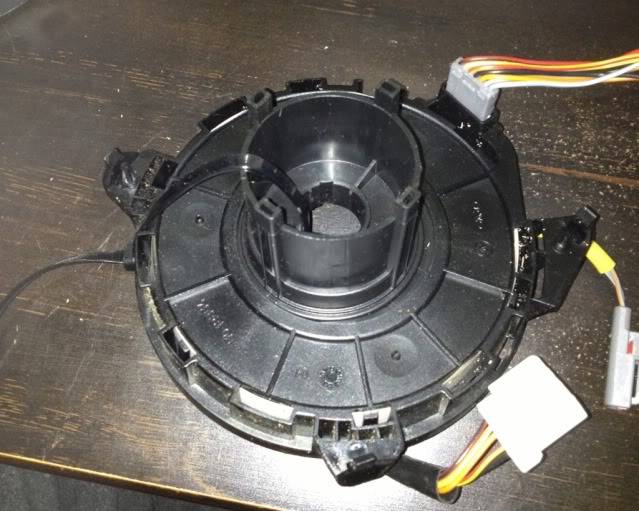

here's a spare one I have, hope these pics help. @ Sapper, if you are interested, I have it zip-tied right where it was when I took it off the steering shaft, lmk how much
