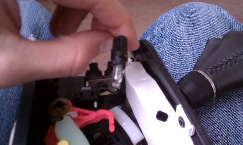

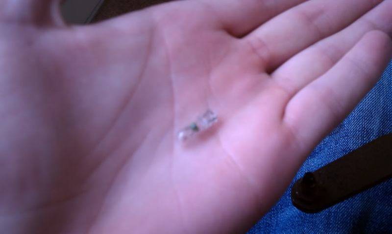

SST shifter has TWO lights, both on the driver's side. Standard shifter has ONE light.
Very strange that the + and - light up, but not the others. The lights actually are at the P/R/N/D side, and there are light guides that reach over to the +/-. Might just be dirty?
Just pull it and take a look. Can be done in less than half an hour. The top plate just pops off the shifter. Pull the upper console, pull the shifter knob, pull up on the shifter top plate. Comes right out.
