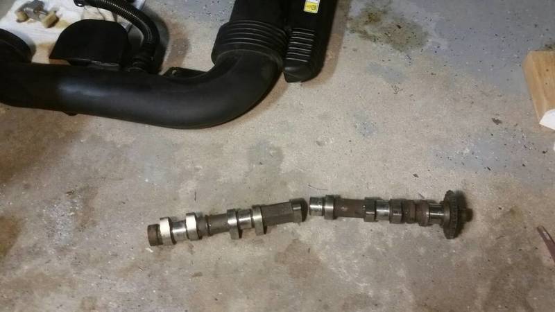

So, I replaced the valve cover gaskets and chain tensioners. Apparently, I didn't get something torqued properly on the camshaft. I'll test tomorrow to see if there's valve damage.
Anyone know a good source for a replacement passenger side exhaust camshaft?

I'm hoping to get it done next week. Is there a difference in the cams between the 3.9 and 4.0? If so, don't worry about it. I'm hoping to only replace the one.

Thanks. Don't worry about it. I'm going to check ebay and then local salvage yards.
Just tested the valves and they're all good. Thank god.
I should be back on the road by midweek.

I'm back on the road tonight. Swapped in the new cam. made sure everything was torqued correctly. I manually turned the engine a few times to make sure everything was happy and nothing was hitting. torqued the cam again with pressure on different valves to make absolutely sure again. I'll be damned if I was going to break another one.
I'll be babying it for a while. But I'm so happy to have my LS back.
