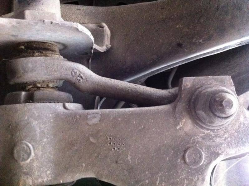

Tow compensators are bad, mine did the same thing. Little dog bones on the front side of the rear lower inner control arm bushing for the rear end.

Couple of picks.
Check the shocks too but my guess is these little guys are bad.

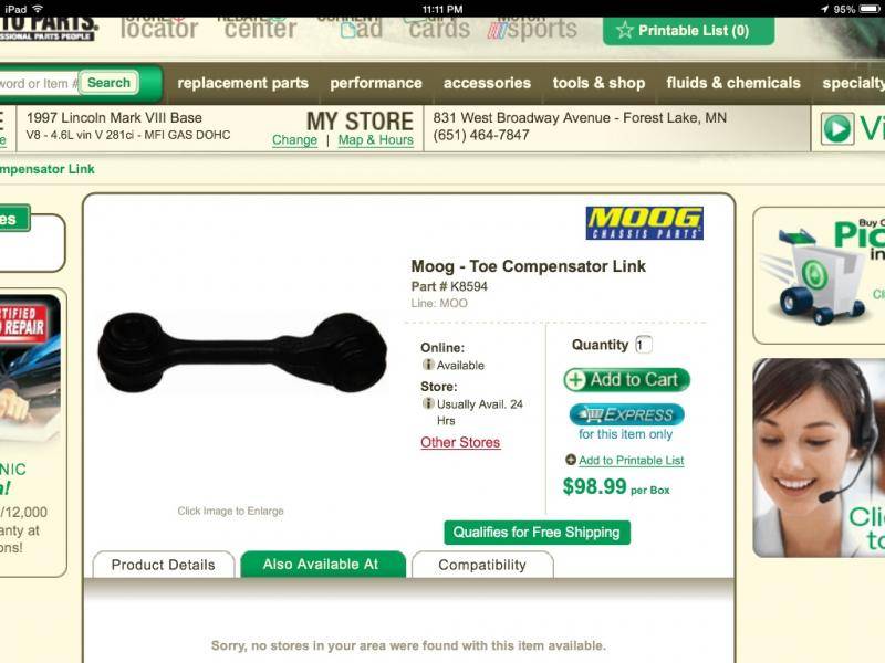

Thanks for posting that.I went out and ordered a set of these from oreillys today.They have to order them and will be a week to get them.Moog parts for 35 a side.not too bad a price.Look at the pictures at the store because they do not call them tow compensators.Thanks again,I would have never thought of those.
That would be a great price, I just checked their site and they are more than double that.
Make sure they are getting you the right part.

They are cheaper on Rock Auto.
This make me wonder if someday the compensator will be a rare part, and pick up 2 while they are still available.

One big bolt, one smaller bolt... Out she comes. Put the new one in and line up the holes.
Don't pull the big bolt that goes through the lower control arm all the way out, just enough to get the tow compensator out.
