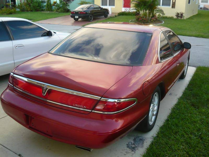

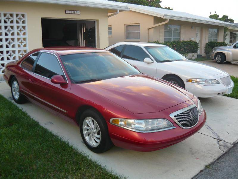

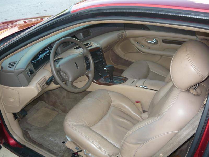

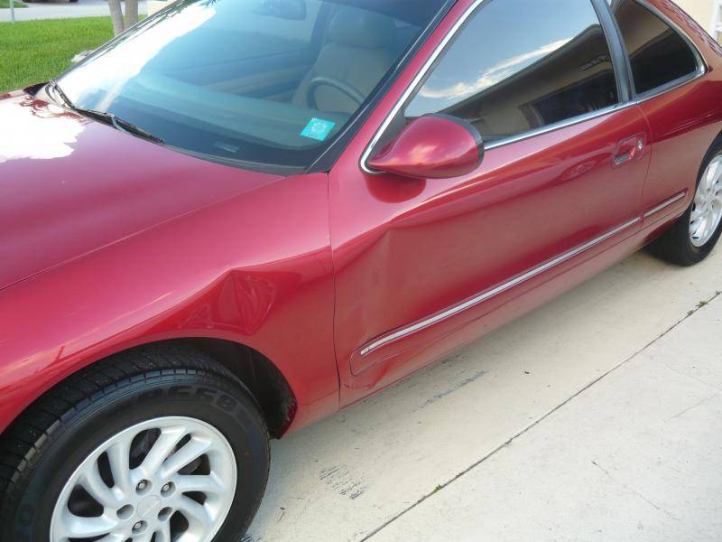

Here are the pics I promised...

Are you the one that replaced the headlights? Decent looking car although I would be worried about the collison history.
For $600 I could care less about the collision history. The door dent is from someone backing into it with a trailer (so I'm told...). It is all original paint. The bumpers could a repaint though. The lugs are missing because the metal covers tore off. It doesn't move anyway. I'm sure I will find them in the junkyard. I didn't replace the headlights. I just cleaned them up with some rubbing compound.

I didn't know that some second gens had chrome trim around the lights. It looks ridiculous. Should be color matched like the white one in the same pic.
