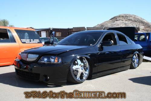

I will use this as a perfect example Iancusp.
Tilting your wheels inward or outward is camber. This has seriouse -/camber, a bit to much but its still in the ball park
