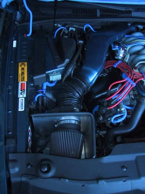

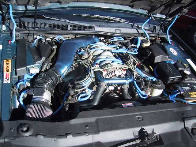

Here's some old pics...
That was before the IceBox...
BTW - the above pictured installation of the IceBox is incorrect. The clamp securing the filter to the MAF is supposed to be OUTSIDE the IceBox. ;)
These and other pics can be found by clicking the link in the sig below.
