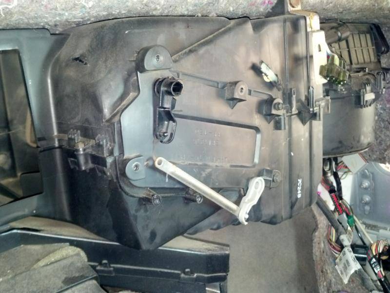

If it helps
Pic with no dash or controller
Yes its normally connected to the black one

i would like to say thank you to chargerxr for the good advice and slowmkviii for putting the picture up. took me a while to find the little arm though. found this guy in there too. i have heat now
