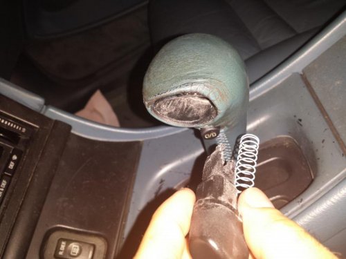

My shifter knob has always been a little loose, but today while driving back from autozone it and the spring popped out. Scary as hell, I was wondering if I could get it into park once I got home. I could, but it's super loose and unsecure and obviously needs to be fixed or replaced ASAP.
It looks like the plastic is cracked. Is it repairable, or just replace the whole shifter? Can I just use a replacement button, or no?

That happened to me years ago. Just leave the spring out and put the button back in and your good to go until you find another one. I've been using it like that for a long time now.

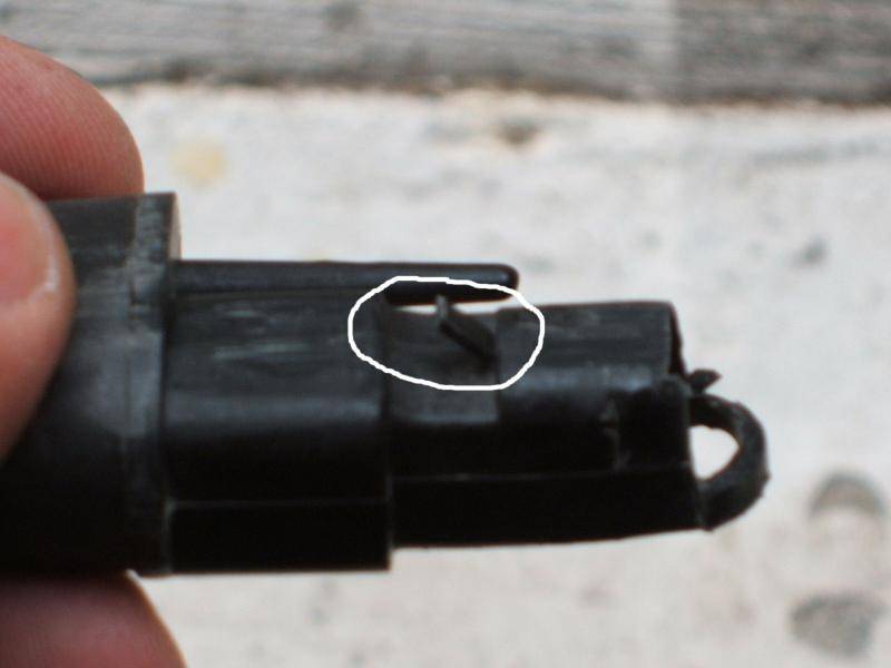

On your button broken hook.

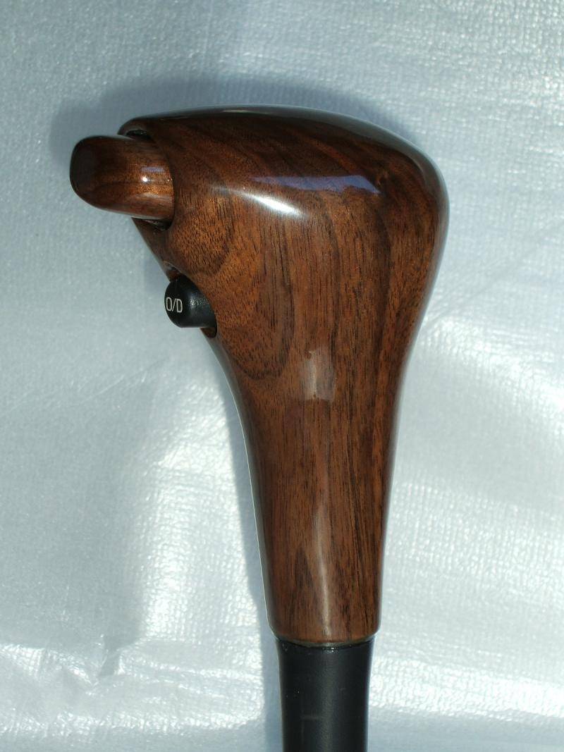

I have F.S. Wood Shift Knob Custom made For Lincoln Mark VIII 93-96.
Made from natural Walnut: $100.00 shipped.
I make Custom wooden Steering Wheels and Shift Knobs.

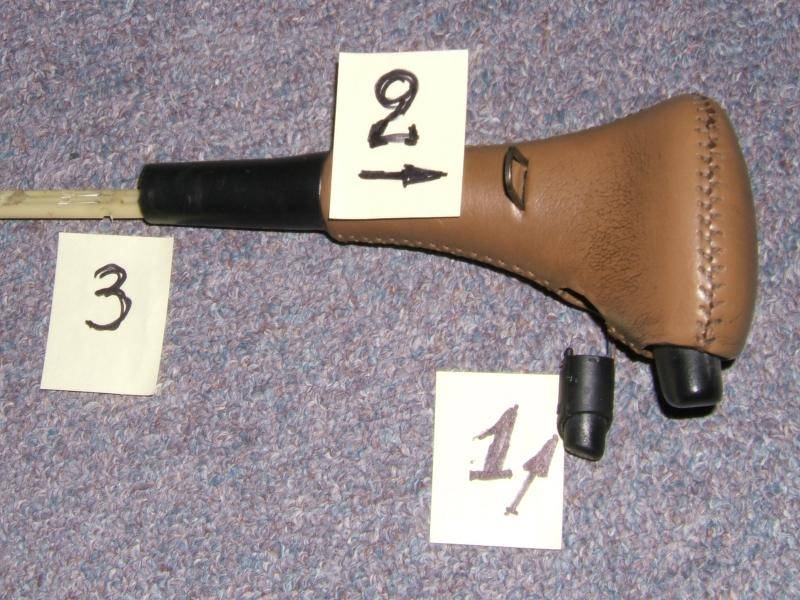

For the Mark VIII 93-96 it's important to change the OD button first because of the way the electrical contacts work:
1. Carefully take out the O/D button.
2. Take out the shift knob fastening;
3. Carefully remove the shift knob;
To install a new shift knob do these steps in reverse order because of the O/D button contacts! (It is possible to damage contacts of the O/D button!)
