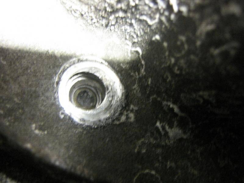

i broke the head off of one of the bolts that go around the drain pan any ideas of how I can remove it...i hope it doesn't leak
Those are tiny, going to be tricky. You have to drill it with a small bit, and use an ez-out, or other removal procedure. YouTube has good videos.

Was it cross-threaded, frozen, or overtightened? If you do drill it out, get left hand drill bits. You may get lucky, and it'll just bite and spin out.

over tightened i'm guessing it wont come out easy

It still might come out easy, all the tension is off the bolt once it snaps.
Try just turning it with a small drill bit on the edge of the bolt.
