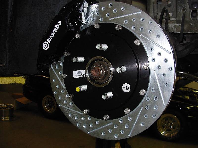

Here is a list of items/part numbers being used to convert my Mark VIII hubs over to Mustang 5 x 4.5 bolt pattern, and also what is needed to convert the fronts over to a Brembo 4 piston big brake setup.
Please note that you will need 18" rims to clear the Brembo's. Even then, check with your rim manufacturer to make sure that your 18's will clear them. I had to have my rims custom made to clear the Brembo's. I will post pictures of the install in 2 weeks.
M2300X Ford Racing/Brembo 13in 2000 Cobra R Front Brake Kit
136-2261002 Baer Eradispeed Extreme Plus 2 piece Front Brake Rotors for 1999-2004 Mustang Cobra

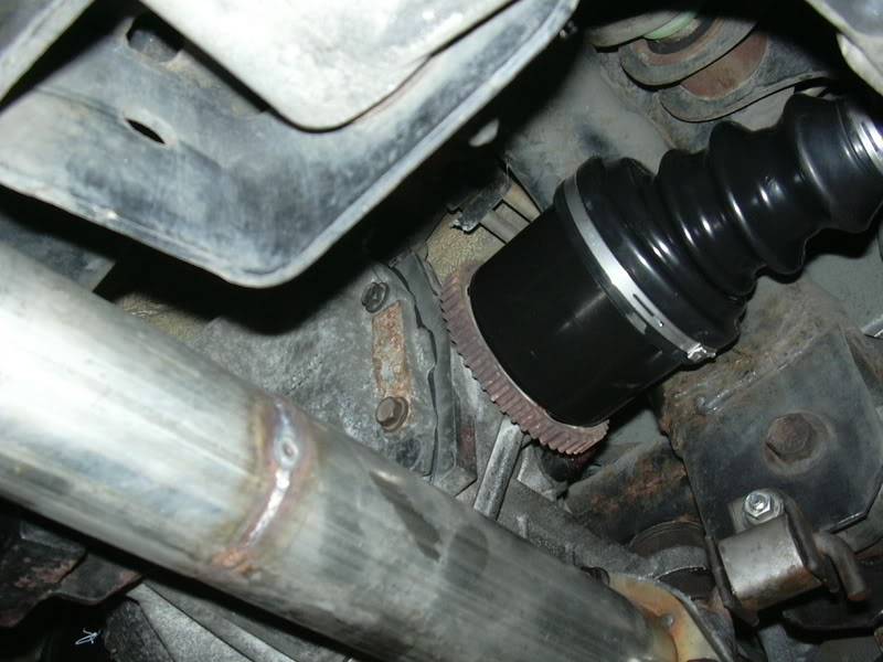

And HOPE TO GOD that your axle isn't seized in the hub on the passenger side. If you cant get it out with a simple hub puller, start looking for a new axle and knuckle. gen1 and gen2 will work.
the fronts took no time to do, the rears took MONTH's off of my life. Here are some pictures to help you.

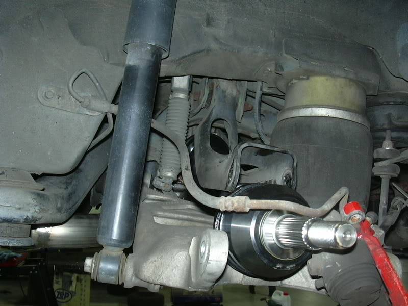

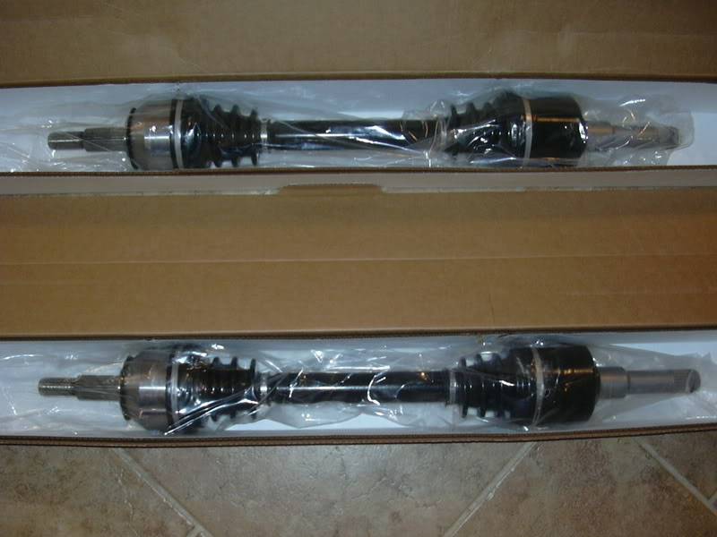

I have had the entire rear already rebuilt, except for the new brakes and hubs being done now. I have brand new Raxle SC T-Bird half shaft axles installed, along with some extra diff bracing, 410's and T-Lock. Guess from your experience, I made the right choice to have Aric do this install :)
Just and FYI, the 1998 Mustang Cobra 17x8's are supposed to clear the brembo calipers. Also 1995 Mustand Cobra R 17x9's will clear.
The SC half shafts are holding their own so far helping me get low 1.8 60' times at the drag strip on 255 drag radials on stock rims with 401rwhp.

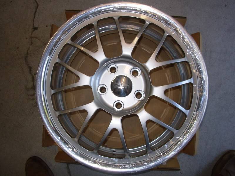

About the rims... the message is, to check and make sure the rims will work with the Brembo's before you buy them. My first rim choice, custom made Forgeline 18's, would not clear the Brembo's. The Forgeline engineers tried everything to make them work from the measurements that Aric at Injected Engineering provided to them, but the numbers were not there to fit without interference. I had to go with my second pick - Boze 18's mounted on 255/40's in the front and 285/35's in the rear.

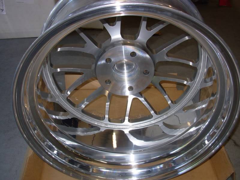

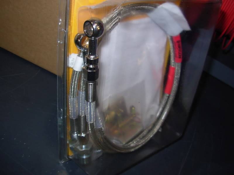

Dropped the Mark off at Injected Engineering today :) Aric is going to start the transformation after he is done tuning a car. Here are some pictures of one of the Boze rear rims with the correct bolt pattern, and the Classic Tube SS brake lines. Tyler was kind enough to weigh the rear rim for me, and it came in at 24 1/2 pounds. All goes well, it might be done this week :)
I will be very disappointed if I can't squat like that anymore. I have gone to great lengths to have the custom made 18x10 wheels and tires fit inside the wheel well, and to keep the Mark lowered. No 4x4 look for this Mark. :)

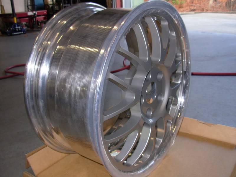

There was no guessing with these rims. Everything was measured on the car, and the specs were then given to Boze to build the rims to Aric's spec's.
Boze screwed up the first set of rims by drilling the Mark VIII bolt pattern in them. At over $4k a set, there was no way I was going to have them use spacers and re-drill them for the Mustang bolt pattern. They had to start over and make a new set.
Before Aric shipped the first set of rims back to Boze, he mounted them (without tires) on the Mark. The offset is perfect, and the rim just hits the sway bar when snugged up just as he wanted them to. They might have to roll the fenders - at a last resort, but the goal here was to keep everything inside without body work. On the stock rims, I measure 22 1/2" from the bottom of the rim to the top of the wheel well.
Joey Bell is the man when it comes to custom chassis fab work. He will make it all work. :)
The rims look great but I hate to be the bearer of bad news... They are only ~9" wide rims. Rim widths are measured from the inside edges where the bead sits. My 8.5" rims measure 9.5" edge to edge...
What size tire are you putting on them?
I agree they are 9", and that is how they were ordered. For wheel well fitment discussion, I called them 10", because that is what they actually measure. This is the widest rim I could use with that particular wheel center section and still have a tiny lip.
Originally, they were 10" (11" measured), but Boze came back and said there would be a lip on the fronts, and no lip on the rear. In fact, these are two piece rims that are usually bolted together with the bolts pointed inboard, but the centers are pushed so close to the edge they had to weld them instead. These are one of a kind rims. Boze has never made a set of rims for a Mark VIII before mine. Sorry if I confused anyone. :)

We are waiting for the front SS lines from Classic Tube to arrive. I was told they have the correct fitting on them for the Brembo calipers. Should be here tomorrow. I should have some pictures of the progress by Friday or Saturday.

Thanks Guys :) All the props though, need to go out to Aric Carrion with Injected Engineering. He is the one that made this build reality. I just paid the bills...
